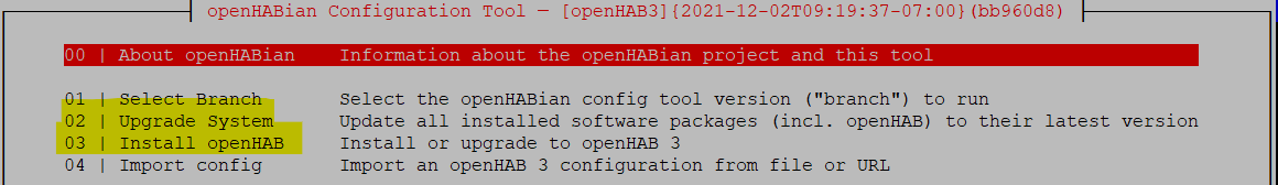

I tried the upgrade from OH3.1 to OH3.2 according the instructions on Github:
Upgrade Process
openHABian
If you are working with an openHABian setup, the upgrade is quite easy. Regardless of if you are currently using the openHAB 2.5 or 3.x stable release or one of the latest 3.2.0 SNAPSHOT or milestone builds, switching to openHAB 3.2.0 stable is done in just a few steps:
Connect to the SSH command line and execute: sudo openhabian-config
When being asked, answer that you want to update.
Select the menu entry"03 - Install openHAB" option.
I first did a backup of the OH configuration and then selected menu entry “03 - Install openHAB” as recommended on Github for those with an openHABian setup and currently using 2.5 or 3.x (in my case openHABian with OH3.1.0)
The Upgrade FAILED (openHAB 3 already installed)
openhabian@openhabian:~ $ sudo openhabian-config
2021-12-23_14:46:26_CET [openHABian] Checking for root privileges… OK
2021-12-23_14:46:26_CET [openHABian] Loading configuration file ‘/etc/openhabian.conf’… OK
2021-12-23_14:46:26_CET [openHABian] openHABian configuration tool version: [main]{2021-12-17T07:21:22+01:00}(49335e5)
2021-12-23_14:46:26_CET [openHABian] Checking for changes in origin branch main… OK
2021-12-23_14:47:58_CET [openHABian] Switching to branch main… OK
2021-12-23_14:47:58_CET [openHABian] Adding slightly tuned bash configuration files to system… OK
OK
2021-12-23_14:48:32_CET [openHABian] Creating openHAB config backup… OK
2021-12-23_14:54:23_CET [openHABian] Updating Linux package information… OK
2021-12-23_14:54:23_CET [openHABian] Preparing openHAB installation… FAILED (openHAB 3 already installed)
Did I misunderstand the instructions on Github? Any idea what I need to do differently?

After you flashed, you did wait for the entire thing to finish installing/booting/rebooting before restoring the backup?
For me it was not always obvious it was still installing. So wait after you first boot up the image till it is done isntalling rebooting etc. Then the UI should come up, see if that whole thing is ok. Then try to restore the config. Then wait again, till everything is done. You could try to clear the cache (via openhab-cli command). Other then that I have no experience with those errors. Maybe check if all the file permissions are still ok as well.
