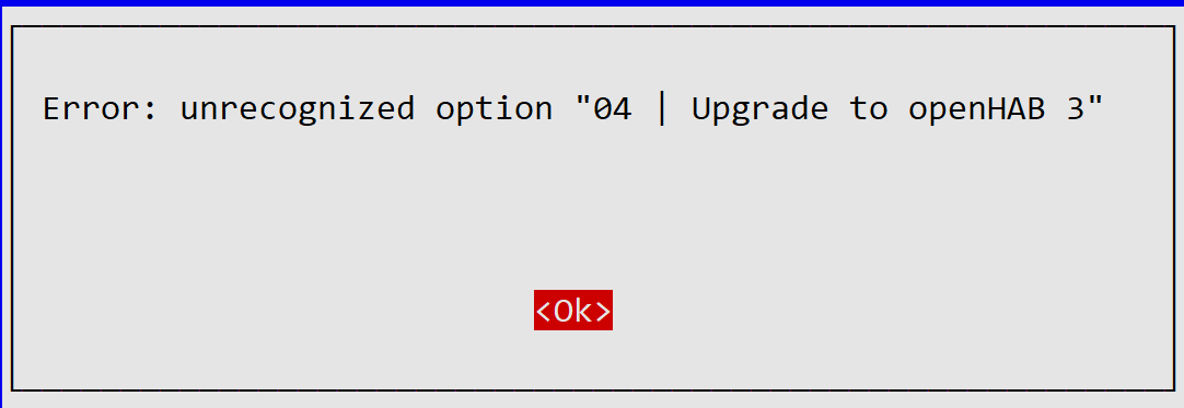

I’m trying to switch branch from OpenHabian 2.5.10 to 3M2, but not getting past ‘openhabian-config’.
Every time I run it I’m told that it needs to update itself, which it appears to do. I then select ‘branch’, and choose OH3 BETA. Option 4 then appears in the list, but if I try and select it I get an error:

Because you keep failing to switch to the master branch BEFORE anything else.
Which the docs, pointed at again above, clearly state is a prerequisite
You have no “upgrade” menu option because you are not on master.
I can’t switch to the master branch. When I try, I see the update scripts run, log out of openhbian-config, see a line in the console saying switching to stable branch. Every time I run the config app this happens; needs to update itself, says I’m not on stable, or master, invites me to change … repeat until very bored!
Try to “cusor down” to master, “blank” to select, “tab” to execute “enter” to start the change.
That did it for me some time ago. I’m running quite an old version of openHABian (updated, yes … anyway strange behaviour here and there) and unterlaying os version, though.
openhabian-config offers to update itself whenever there’s new code for the current branch.
Read the window title and text (it should tell you the branch you’re on).
You actually need to actively select master. The asterisk marks your selection so get that moved to the master line before you press enter to proceed.
