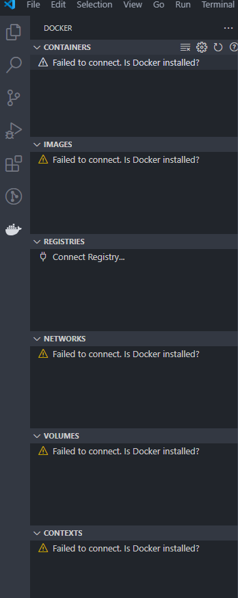

This is a picture what I get in the GUI. I never saw this before
It’s been years since I’ve used the VSCode openHAB extension but the warnings and errors are fairly straight forward.
The first is complaining that you have an openhab.host property set somewhere and that field is deprecated. I don’t actually see the property here in your settings.json but I also don’t see any property telling VSCode the IP address or domain name of the openHAB host machine. This probably leads to the second error…
The second error is that the VSCode extension cannot connect to the LSP port (5007) on the running openHAB. Since there is no property telling it where OH is running it’s probably trying to connect to localhost.
