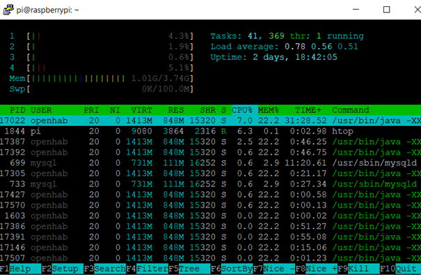

Topic Raspberry, here I think OH3 comes to the limits for PI3 systems. Memory requirements are higher, CPU performance is not a problem in my opinion.
HTOP on Raspberry 4:
For Raspberry PI 4 system I can only recommend everyone to switch to a SSD.M2 USB3. There are several tutorials on the net. The factor speed is felt factor 10 or more. The start of the system is very fast compared to SD card. Unfortunately, there are only M2 cards from 240 GB (about 40 € + 20-30 € for housing) of which I use only 32 GB. The rest is reserve if you need a 2nd drive. In any case more stable and durable.

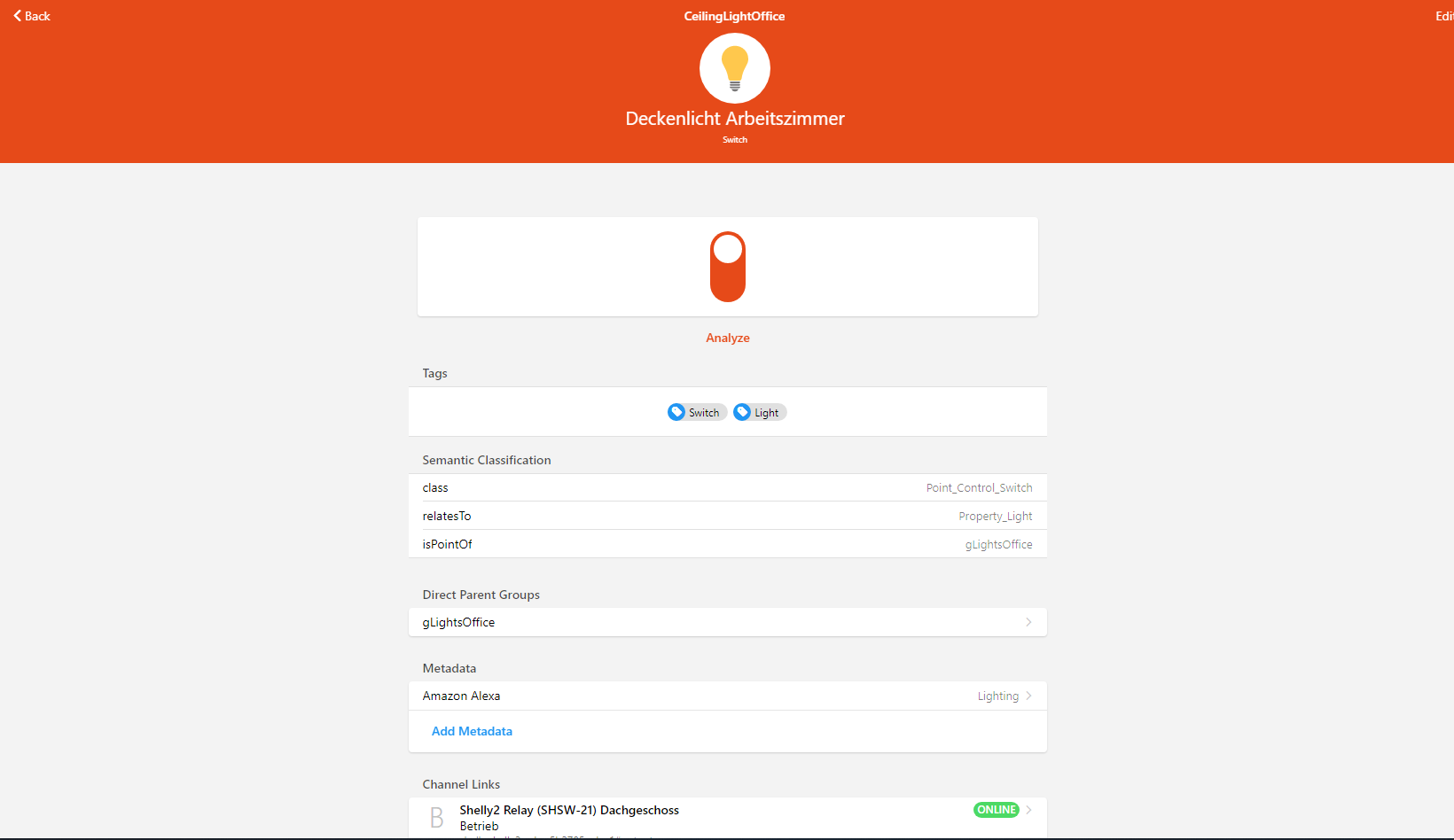

Who says you can’t ???
This is the item view of one of my light switches. Ther is a big orange switch just above analyze.
Guess what it does
:slight_smile:

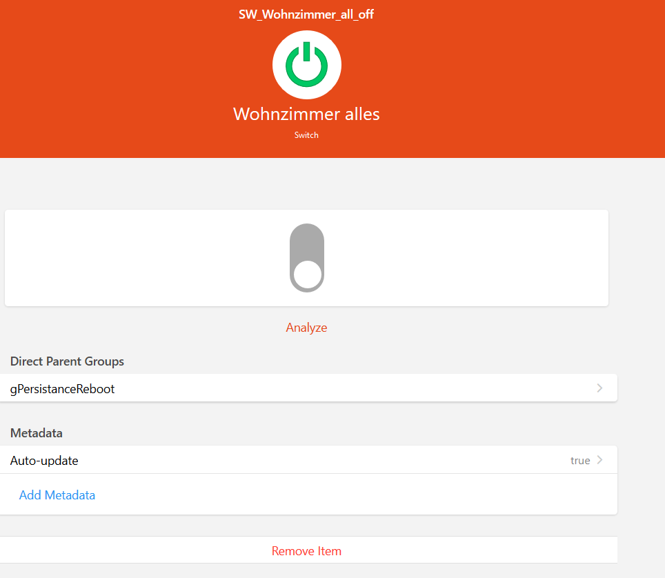

Yes, I have it too :slight_smile: but if I switch on and refresh the browser - status is always off.
OH log shows
2021-01-08 19:11:07.905 [WARN ] [apache.cxf.jaxrs.utils.ResourceUtils] - No resource methods have been found for resource class javax.ws.rs.core.Response
the event log show all correctly
2021-01-08 19:11:03.209 [INFO ] [openhab.event.ItemCommandEvent ] - Item 'CUX_FLEX_8_1_State' received command ON
Your Example doesn’t looks like that it is migrated. From my end after migration a “normal Switch Item” looks
This is the same message which I got if I open habpanel on the Echo device - but this is another issue.
If I switch this item in a rule or in habpanel (on my base lapstop) or in a sitemap then it works - only Main UI has this problem. Looks like the status of a switch will not updated in MainUI. I found some other topic in the community where have simular problems, mostly with MQTT.
But this is post is not a question to solve problems, this is only my experience about the way and some problems with the upgrade.

Nope. I run on RPi3 as well and memory usage has not increased when I migrated.
You use about twice as much as my system does. That’s definitely not normal. I have never seen anyone use that much memory on ARM. It could be a memory leak but it’s probably not OH itself but bad OS and/or java parameters.
