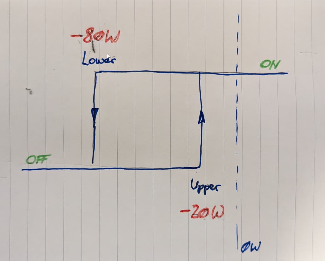

My purpose is to activate the smartplug whenever my PV modules produce a surplus. Logic behind would be turn on (upper: -80W) and turn off (lower: -20W) - correct? When doing this, the smartplug is ON at +340W consumption. Same ON state for cross-changing upper and lower values.
I believe the correct setting is, upper: -20W, lower: -80W and state inverted. :roll_eyes:

All I can say is pay attention to the negative numbers. -80 < -20 so wouldn’t -20 be the upper value and -80 the lower value?
Hello @rlkoshak ,
I could test my settings today and can confirm that my requirements were able to setup by UI without rules.
Based on the attached drawing, the hystereses was setup, Upper to -20W, Lower to -80W and output inverted.
This leads to the correct behaviour to only switch the smartplug when enough surplus is generated from my PV system.
