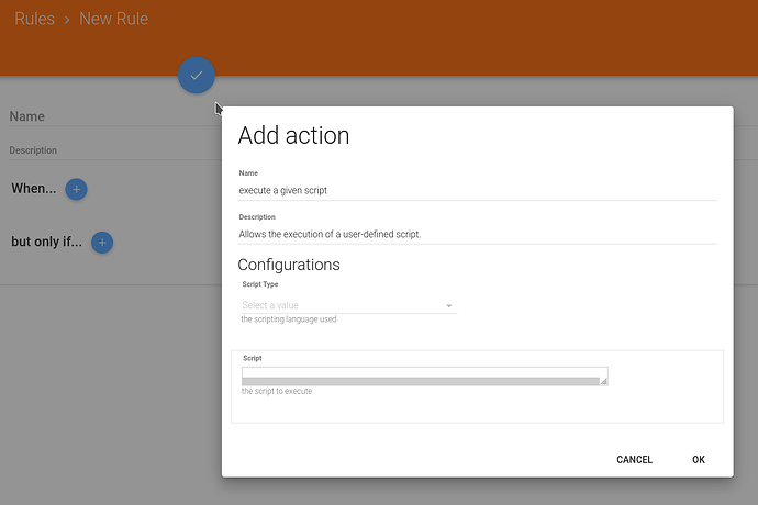

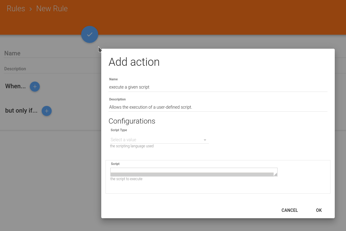

Using a script Action in the Paper UI rule editor
When you use ‘execute a given script’ for the Action…
… you need to select the Script Type from the available ScriptEngineFactories and then enter the actual script into the editor. This action does not read script files and it does not work with rule DSL scripts.
