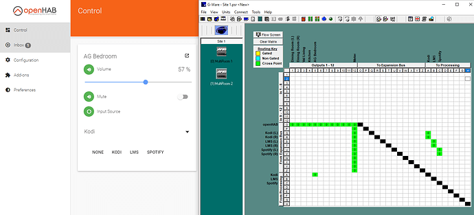

I’m working on a Binding for a ClearOne audio matrix (ClearOne XAP) and have it successfully showing me the names of my sources in the “Source” Channel in the Control section of PaperUI:
Processing A is correctly renamed to “Kodi”, Processing B to “LMS”, Processing C to “Spotify”
