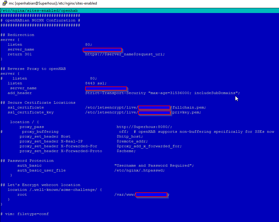

Hello All ,
I have a simple question , what i need to add in to the nginx configuration file in order to allow the acces to the port 9001 (openHAB log viewer)
as a example
when i access the DNS addres (example) : https://superapartment.com i insert my user and pass
then i access the log viewer from OH2 but i have a error
This address work : http://192.168.100.3:9001/
This address it does not work : https://192.168.100.1:9001/
The port forwarding is working , on the port 9001 because i can access using HTTP.
I know i have to add some extra information in to the ginx configuration
Here are my setting from the nginx
If is necessary i will add also the log file from nginx
Hi @Radu10, you redirect http (port 80) to https (port 443) but your NGINX configuration listens on port 8443.
Hello @noppes123,
the openHAB use the port 8443, there is no port 443 in my nginx configuration file .
and the logs use the port 9001 ,
i was thinking to duplicate the port 8443 but only some configuration i will be add in the new
i don’t want to destroy my server for the 5th time .
When i set up the nginx i use the openHAB system configuration for a fast configuration .
What @noppes123 mean is that if you connect via http (port 80) nginx will redirect to https (port 443), but then there’s nothing listening on that port.
Edit: if you are trying to access the logviewer directly that won’t work via https. Frontail (the log viewer) listens to port 9001, but it provides no ssl. To make it work you need to duplicate your nginx config (the second server-block) but make it listen to port 9001 and proxy to http://<your_local_address>:9001
Edit 2: this might create a port conflict though, so it’s better to choose another port for the external connection (from the internet) that nginx is listening to. The important thing is to make nginx the only thing available to external requests and proxy those to your local server.
Thank you for the information @pacive and @noppes123
is there a possibility to add this configuration in to the actual nginx configuration file , just like adding a new structure for server but using the port 9001 , taking in to the consideration that the port 9001 don’t has a SSL support ?
something similar with this code :
Possible configuration
location /openhab {
location / {
    proxy_pass            **http://openhab-server:8080/;**
    proxy_buffering       off;
    proxy_set_header      Host              $http_host;
    proxy_set_header      X-Real-IP         $remote_addr;
    proxy_set_header      X-Forwarded-For   $proxy_add_x_forwarded_for;
    proxy_set_header      X-Forwarded-Proto $scheme;
    auth_basic            "Username and Password Required";
    auth_basic_user_file  /etc/nginx/.htpasswd;
location /zm {
    proxy_pass            **http://openhab-server:9001/;**
I will try to make a test, and if this is working, i will post the configuration of the nginx configuration file
I appreciate all the work .
