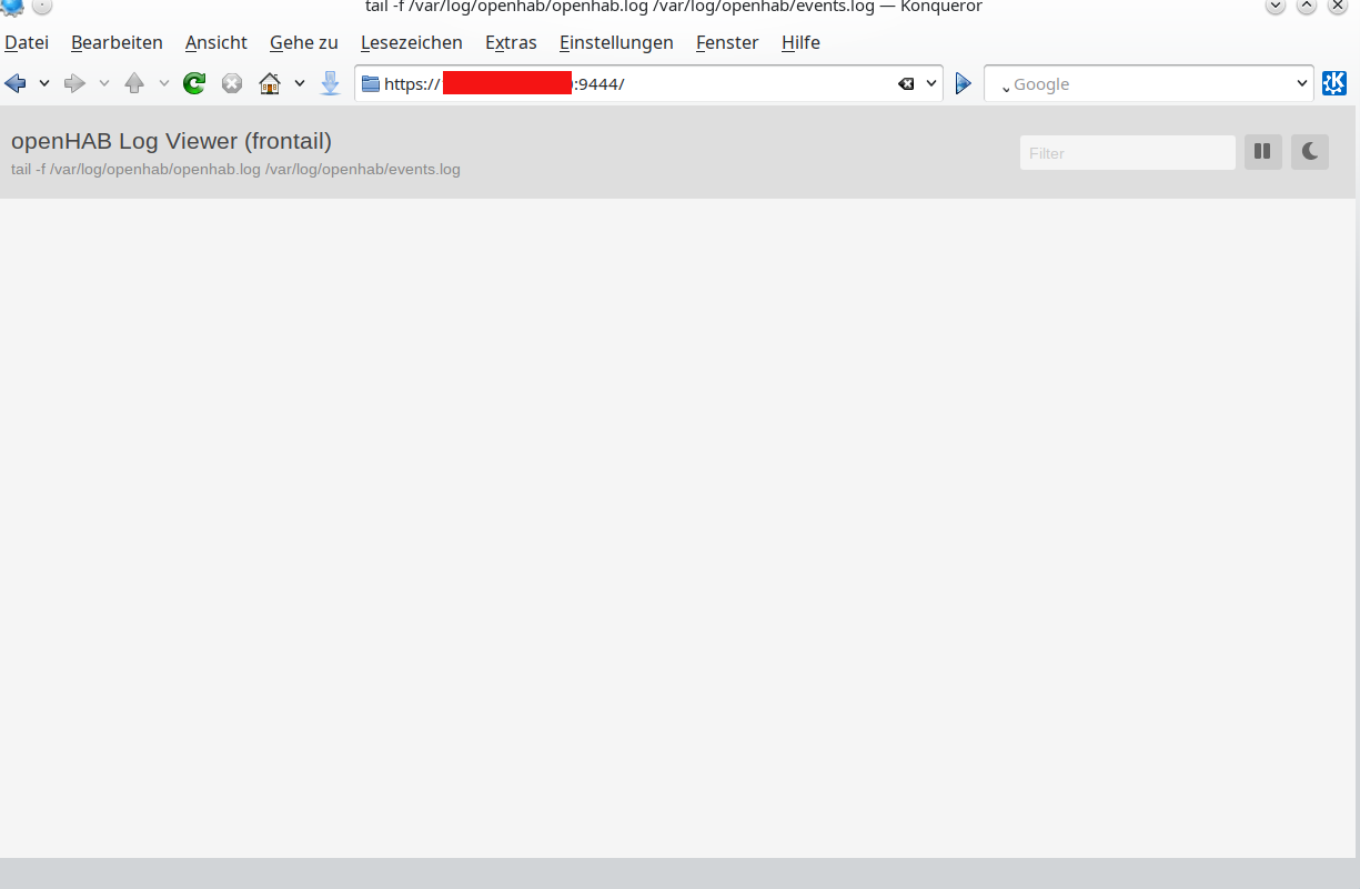

Hi, maybe someone can help me (current openhabian release on a Pi4B, 4GB)
I am currently configuring ssl-protected access from the www, which is working fine so far (via nginx)
Now I am trying to provide access from outside to port 9001 for accessing the log.
https://www_addr:9444 ==> ((nginx)) ==> http://openhab:9001
The log page is displayed in principle, but remains empty. What could be the reason for this?
My nginx site configuration for the log:
server {
    listen                                    9444 ssl;
    listen                                    [::]:9444 ssl;
    server_name                               xxxxxxxx
                                              xxxxxxxx.xxx.xxx
                                              xxxxxxxxxxxx.xx
                                              xxx.xxx.xxx.xxx
    ssl_certificate                           /etc/ssl/openhab.crt;
    ssl_certificate_key                       /etc/ssl/openhab.key;
#    ssl_certificate                           /etc/letsencrypt/live/[DOMAIN]/fullchain.pem;
#    ssl_certificate_key                       /etc/letsencrypt/live/[DOMAIN]/privkey.pem;
#    add_header                                Strict-Transport-Security "max-age=31536000";
    # Cross-Origin Resource Sharing
    add_header 'Access-Control-Allow-Origin' '*' always;
    add_header 'Access-Control-Allow_Credentials' 'true' always;
    add_header 'Access-Control-Allow-Headers' 'Authorization,Accept,Origin,DNT,X-CustomHeader,Keep-Alive,User-Agent,X-Requested-With,If-Modified-Since,Cache-Control,Content-Type,Content-Range,>
    add_header 'Access-Control-Allow-Methods' 'GET,POST,OPTIONS,PUT,DELETE,PATCH' always;
    add_header Set-Cookie X-OPENHAB-AUTH-HEADER=1;
    proxy_set_header Authorization          "";
    location / {
        proxy_pass                            http://localhost:9001/;
        proxy_set_header Host                 $http_host;
        proxy_set_header X-Real-IP            $remote_addr;
        proxy_set_header X-Forwarded-For      $proxy_add_x_forwarded_for;
        proxy_set_header X-Forwarded-Proto    $scheme;
        proxy_read_timeout                    3600;
        auth_basic                            "bla";
        auth_basic_user_file                  /etc/nginx/.htpasswd;
EDIT:
I just saw these log entry. But what does it mean or how can the problem be solved ?
2022/10/16 18:54:31 [error] 26921#26921: *690 connect() failed (111: Connection refused) while connecting to upstream, client: 192.168.xxx.xxx, server: openhab_pi, request: "GET /socket.io/?EIO=4&transport=websocket HTTP/1.1", upstream: "http://[::1]:9001/socket.io/?EIO=4&transport=websocket", host: "192.168.xxx.xxx:9444"

        proxy_store                           off;
	 # that is important otherwise too many sockets in your log
        access_log                            off;
        auth_basic                            "Enter pass ?";
It’s also important to change the file “/etc/systemd/system/frontail.service” (see the comment in the config file) and also change the links in “/etc/openhab/services/runtime.cfg” from
http://[MYLOCALIP]:9001
to
http://[MYLOCALIP]:9001/log
That’s it.
2. A second problem was how do I get the timelinepicker to work behind nginx.
In my sitemap the entries looked like that:
Webview label="Zeitplan" icon="line" url="http://[MYLOCALIP]:8080/static/time-line-picker/index.html?ip=[MYLOCALIP]:8080&transferItem=IFO2R_TLP_TransferItem&yAxisLabel=1,2,3,4,5,6,7&lang=de&states=Aus,Nacht,Tag,Heizen&colorset=2&deactivation=true" height=15
I changed it to
Webview label="Zeitplan" icon="line" url="http://[MYLOCALIP]:8080/static/time-line-picker/index.html?ip=http://[MYLOCALIP]:8080&transferItem=IFO2R_TLP_TransferItem&yAxisLabel=1,2,3,4,5,6,7&lang=de&states=Aus,Nacht,Tag,Heizen&colorset=2&deactivation=true" height=15
and also changed the timelinepicker file “…/openHAB-conf/html/time-line-picker/js/switchPointSet.js”. For this search the line
this.ip = 'http://' + openHAB_ip + '/rest/items/';
and change it to
this.ip = openHAB_ip + '/rest/items/';
Then you can tell nginx to replace the outgoing site-data with these lines in the config file:
	    sub_filter                            'http://[MYLOCALIP]:8080' 'https://[MYDOMAINNAME]:19999';
	    sub_filter_once			      		  off;
Now I can access OpenHAB, my sitemap and the log (frontail) via the internet and also my timeline picker GUI works.
Another hint: One stumbling block for me was that my server provider secures the servers with an additional external firewall by default. As long as you are on the standard ports (80/22/443), this is not noticeable. However, as soon as you change to another port and have problems with access, you should check whether your provider has an additional firewall. It took me a few hours to find the cause.
