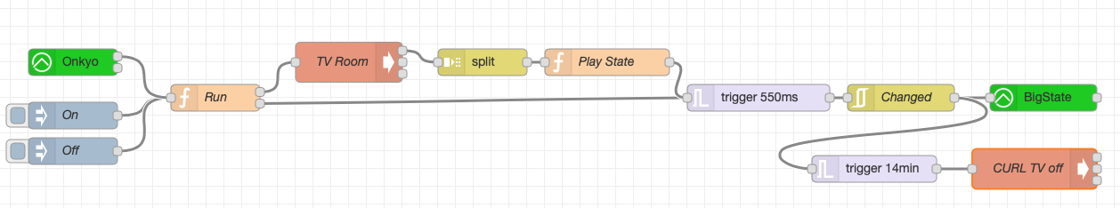

Once you’ve determined which item will trigger this system to start you’re ready for node-red. Here is an overview, I’ll also share what is in each function.
From left to right we have the following:
First the onkyo ON/OFF state. This will always send a payload of ON, OFF, or NULL. I have additional “on” and “off” inject nodes for debugging purposes.
Next is one of the two “big ones” - the function node. The purpose of this guy is to take ON/OFF and put together the command for the exec node to start watching for atvremote push updates. Looks like this inside:

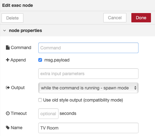

The exec mode is pretty basic, just takes the commands and runs them in the command line. It’s important to set it to “spawn” so that you get the push updates from the atvremote program. Looks like this:

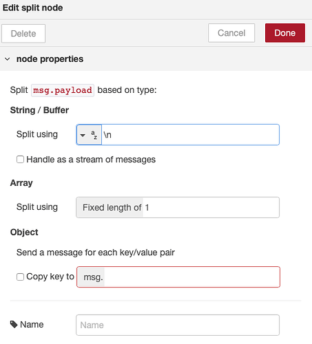

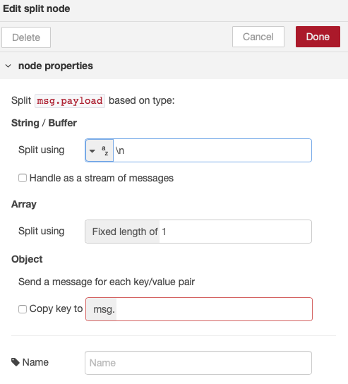

The output of this guy is the money item in this flow. It goes into a split node first (because the messages come out as multi-line items) to filter by line. Split looks like:

So I watch the messages coming from the exec spawn (nicely split by new lines) and send out a 1, 2, or 3 based on what’s happening. These are the messages that eventually go on to openhab so that I can run rules like “when play_state received command 1 …”

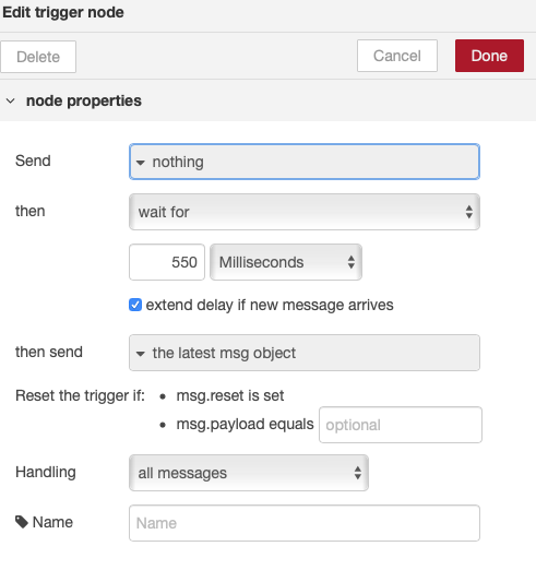

The 550ms trigger is a housekeeping item. I find that when you start some things (netflix is especially bad) they send a few rapid-fire commands going from pause to play to stop to play to fast backward (and on) very quickly while the video loads. The trigger node prevents this from going on to make a disco dance party in my theater room when I start playing a movie. Looks like:
Finally we have a RBE node (only passes the message if it’s changed from the previous message) and goes into openhab as an “item command” for use in rules.
The 14 minute trigger and “CURL TV off” are bonus commands. I’ve linked into the vizio api to turn off my tv after 14 minutes of a 0, 2, or 3 command coming through (1 cancels because it’ll be playing something new). This way my whole system turns off reliably and prevents my 4-year-old from walking away and leaving Frozen playing the title screen for hours.
