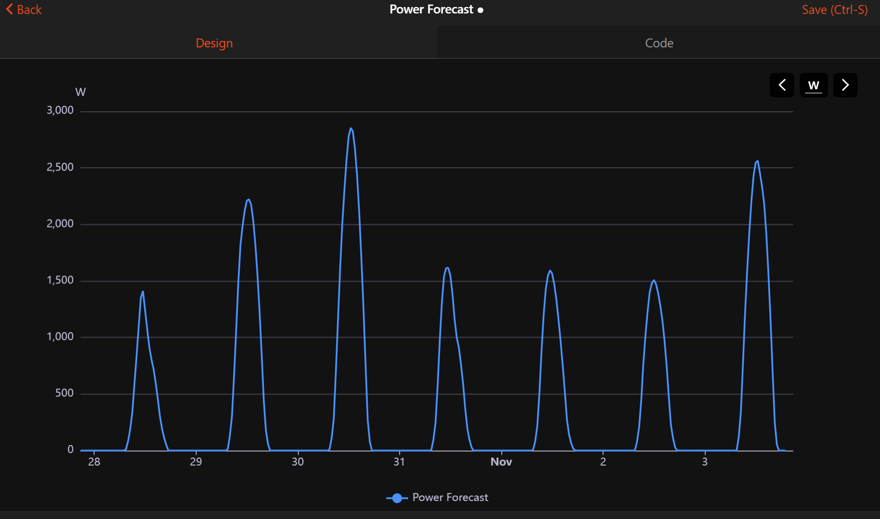

The bell curve you expecting isn’t energy which is adding up. It’s power which you can observe via power-estimate channel.

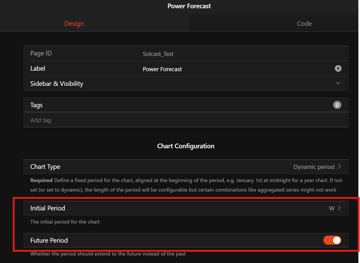

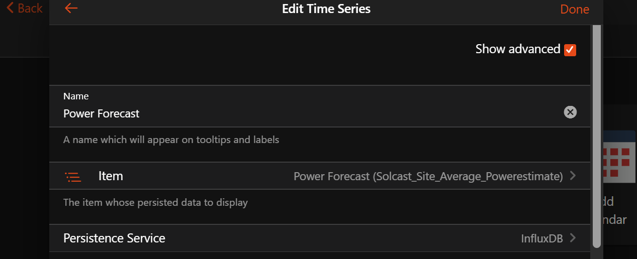

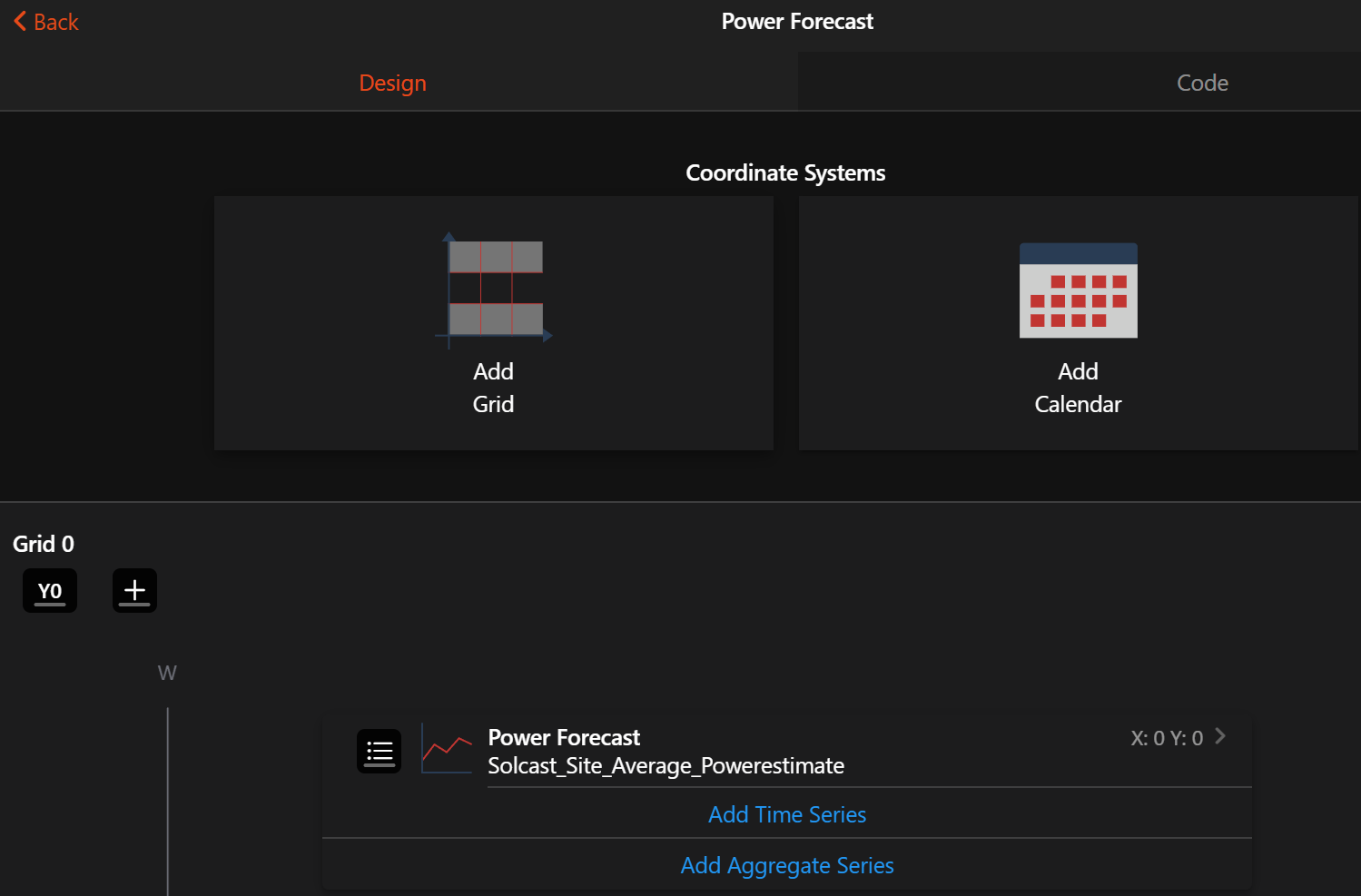

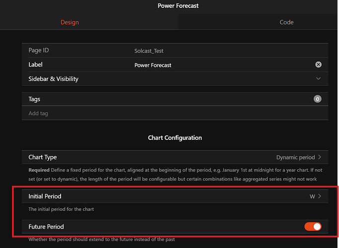

To show it in graph do the following:
Show future period for a week
Pick the item …
.. show advanced settings and select the persistence service like influxdb
After these adaptions you’ll see the bell curves for the next 7 days
