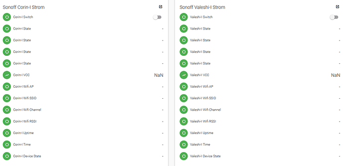

my sonoff S20 switches dont work. I add all, the broker mosquitto is running, the devices connected.
The state updates are not in the event log of openhab. In the openhab.log every time i have trouble logs of double entries with “state”. Its the first time i use sonoff in openhab (Fresh install test system for mqtt2)
I dont know why it now work.
here is my config:
mqtt.things
Bridge mqtt:broker:MosquittoMqttBroker “Mosquitto MQTT Broker” @ “MQTT” [
host=“IP Adress”,
secure=false,
port=1883,
qos=0,
retain=false,
clientid=“Oh2Mqtt2Thing”,
//certificate=“”,
//certificatepin=false,
//publickey=“”,
//publickeypin=false,
keep_alive_time=30000,
reconnect_time=60000,
//lastwill_message=“”,
//lastwill_qos=1,
//lastwill_topic=“”,
username=“”,
password=“”
// Buero
// Sonoff Corin-I Strom
Thing mqtt:topic:CorinI “Sonoff Corin-I Strom” @ “Büro” {
Channels:
Type switch : switch “Power Switch” [
stateTopic=“buero/CorinI/POWER”,
commandTopic=“buero/CorinI/cmnd/POWER”,
//retained=false,
//postCommand=“”,
//transformationPattern=“JSONPATH:$.POWER”,
//formatBeforePublish=“%s”,
on=“ON”,
off=“OFF”
Type string : state01 “Switch State 01” [
stateTopic=“buero/CorinI/STATE”,
on=“ON”,
off=“OFF”
Type string : state02 “Switch State 02” [
stateTopic=“stat/CorinI/POWER”,
on=“ON”,
off=“OFF”
Type string : state03 “Switch State 03” [
stateTopic=“stat/CorinI/RESULT”,
on=“ON”,
off=“OFF”
Type number : vcc “VCC” [
transformationPattern=“JSONPATH:$.Vcc”
Type string : wifi-ap “Wifi AP” [
transformationPattern=“JSONPATH:$.Wifi.AP”
Type string : wifi-ssid “Wifi SSID” [
transformationPattern=“JSONPATH:$.Wifi.SSId”
Type string : wifi-channel “Wifi Channel” [
transformationPattern=“JSONPATH:$.Wifi.Channel”
Type string : wifi-rssi “Wifi RSSI” [
transformationPattern=“JSONPATH:$.Wifi.RSSI”
Type string : uptime “Uptime” [
transformationPattern=“JSONPATH:$.Uptime”
Type string : time “Time” [
transformationPattern=“JSONPATH:$.Time”
Type string : devicestate “Device State” [
stateTopic=“buero/CorinI/LWT”

Paper UI
sonoff console
22:00:33 MQT: Verbindungsversuch…
22:00:33 MQT: verbunden
22:00:33 MQT: buero/sonoff-CorinI/LWT = Online (beibehalten)
22:00:33 MQT: buero/sonoff-CorinI/cmnd/POWER =
22:01:23 MQT: buero/sonoff-CorinI/STATE = {“Time”:“2019-07-13T22:01:23”,“Uptime”:“0T11:06:21”,“Heap”:15,“SleepMode”:“Dynamic”,“Sleep”:50,“LoadAvg”:19,“POWER”:“ON”,“Wifi”:{“AP”:1,“SSId”:“C-Lab Network”,“BSSId”:“9C:3D:CF:49:96:8F”,“Channel”:1,“RSSI”:48,“LinkCount”:1,“Downtime”:“0T00:00:06”}}
22:02:24 MQT: buero/sonoff-CorinI/STATE = {“Time”:“2019-07-13T22:02:24”,“Uptime”:“0T11:07:22”,“Heap”:15,“SleepMode”:“Dynamic”,“Sleep”:50,“LoadAvg”:19,“POWER”:“ON”,“Wifi”:{“AP”:1,“SSId”:“C-Lab Network”,“BSSId”:“9C:3D:CF:49:96:8F”,“Channel”:1,“RSSI”:42,“LinkCount”:1,“Downtime”:“0T00:00:06”}}
22:03:24 MQT: buero/sonoff-CorinI/STATE = {“Time”:“2019-07-13T22:03:24”,“Uptime”:“0T11:08:22”,“Heap”:15,“SleepMode”:“Dynamic”,“Sleep”:50,“LoadAvg”:19,“POWER”:“ON”,“Wifi”:{“AP”:1,“SSId”:“C-Lab Network”,“BSSId”:“9C:3D:CF:49:96:8F”,“Channel”:1,“RSSI”:46,“LinkCount”:1,“Downtime”:“0T00:00:06”}}
22:04:24 MQT: buero/sonoff-CorinI/STATE = {“Time”:“2019-07-13T22:04:24”,“Uptime”:“0T11:09:22”,“Heap”:15,“SleepMode”:“Dynamic”,“Sleep”:50,“LoadAvg”:19,“POWER”:“ON”,“Wifi”:{“AP”:1,“SSId”:“C-Lab Network”,“BSSId”:“9C:3D:CF:49:96:8F”,“Channel”:1,“RSSI”:44,“LinkCount”:1,“Downtime”:“0T00:00:06”}}
22:05:24 MQT: buero/sonoff-CorinI/STATE = {“Time”:“2019-07-13T22:05:24”,“Uptime”:“0T11:10:22”,“Heap”:15,“SleepMode”:“Dynamic”,“Sleep”:50,“LoadAvg”:19,“POWER”:“ON”,“Wifi”:{“AP”:1,“SSId”:“C-Lab Network”,“BSSId”:“9C:3D:CF:49:96:8F”,“Channel”:1,“RSSI”:46,“LinkCount”:1,“Downtime”:“0T00:00:06”}}
22:06:24 MQT: buero/sonoff-CorinI/STATE = {“Time”:“2019-07-13T22:06:24”,“Uptime”:“0T11:11:22”,“Heap”:15,“SleepMode”:“Dynamic”,“Sleep”:50,“LoadAvg”:19,“POWER”:“ON”,“Wifi”:{“AP”:1,“SSId”:“C-Lab Network”,“BSSId”:“9C:3D:CF:49:96:8F”,“Channel”:1,“RSSI”:44,“LinkCount”:1,“Downtime”:“0T00:00:06”}}
Logs:
openhab2.log

i hope you may help me.
I would recommend to cut your problem into little pieces.
  1. Can you switch on/off the SonOff divices using their web-pages (so OH independent)?
  2. Can you monitor your MQTT traffic (with i.e. MQTTlens)?
  3. Can you improve readability? (see my example)
  4. Start with one new device at the time
  5. Do not ignore errors (too much)
  6. Check your “Paper UI: configuration → things” for duplicates?
Seems your problem is in your thing file (for starters). I prefer i.e. to split brigde and things file and for a Sonoff basic (with Tasmota) the thing file is reduced to a simple:
Thing mqtt:topic:Sonoff2 "Sonoff 2" (mqtt:broker:MyMosquitto) @ "MQTT"  {
  Channels:
    Type switch : power          [ stateTopic="stat/Sonoff2/POWER",  commandTopic="cmnd/Sonoff2/Power"]
    Type string : fw             [ stateTopic="tele/Sonoff2/INFO1",  transformationPattern="JSONPATH:$.Version"]
    Type string : hostname       [ stateTopic="tele/Sonoff2/INFO2",  transformationPattern="JSONPATH:$.Hostname"]
    Type string : ip             [ stateTopic="tele/Sonoff2/INFO2",  transformationPattern="JSONPATH:$.IPAddress"]
    Type string : wifi-rssi      [ stateTopic="tele/Sonoff2/STATE",  transformationPattern="JSONPATH:$.Wifi.RSSI" ]
    Type switch : devicestate    [ stateTopic="tele/Sonoff2/LWT",    transformationPattern="MAP:reachable.map" ]
} // end of thing
My suggestion would be to start over slowly. Succes.
