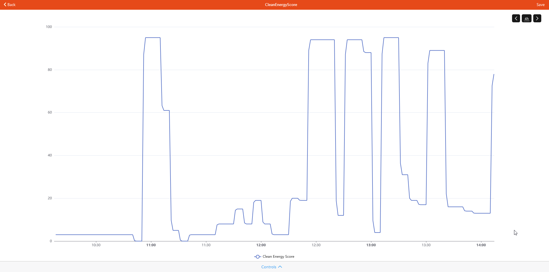

… so it is pretty trivial to create a Channel and Item of type String and use JSONPATH transformation to parse out the token value and put it into that Item. (for continuity’s sake, the item name I used, seen below, is APIWattTimeBearerToken_token

I set up a cron schedule to run this rule every few minutes. The API limits you to no more than 10 calls/second, I believe, so you should not have any problem running into API request caps.
And you should now have a frequent update of how clean your marginal watt of power usage will be!
