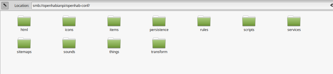

If you are using openHABian and have installed Samba, you can also get this info from the network shares

Thank you both. I don’t see it in Samba but I was ago to go Finder – connect
Samba and VSCode was just a recommendation to make life easier when creating and editing OH files user files that can be found at etc/openhab2/ like these:
Unless you configure /etc/samba/smb.conf to allow access to /var/lib/openhab2/ and that’s not recommended, you’ll need to use another way to view/edit all other files, as you seemed to have done.![]()
