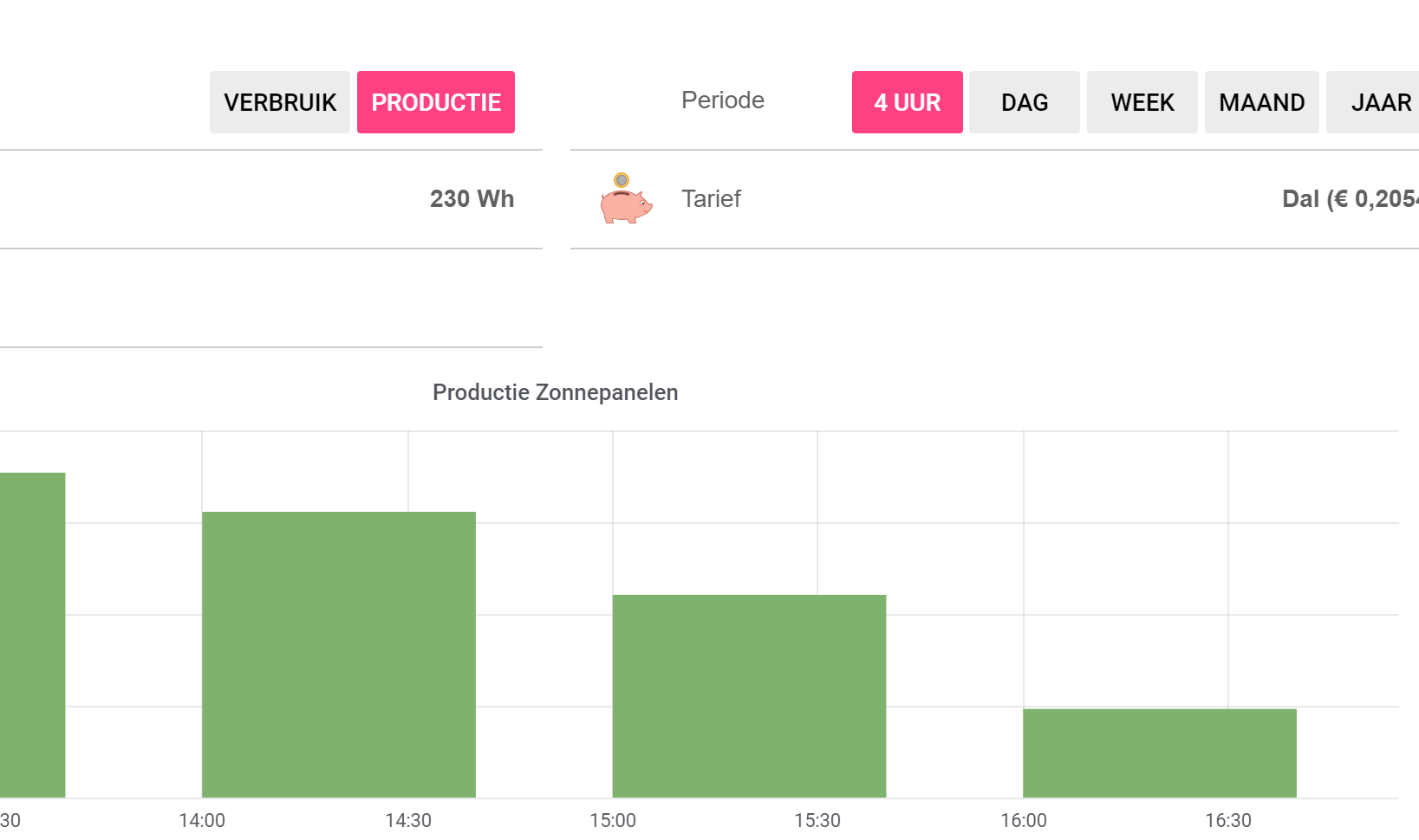

To visualize it, a picture of a correct view:

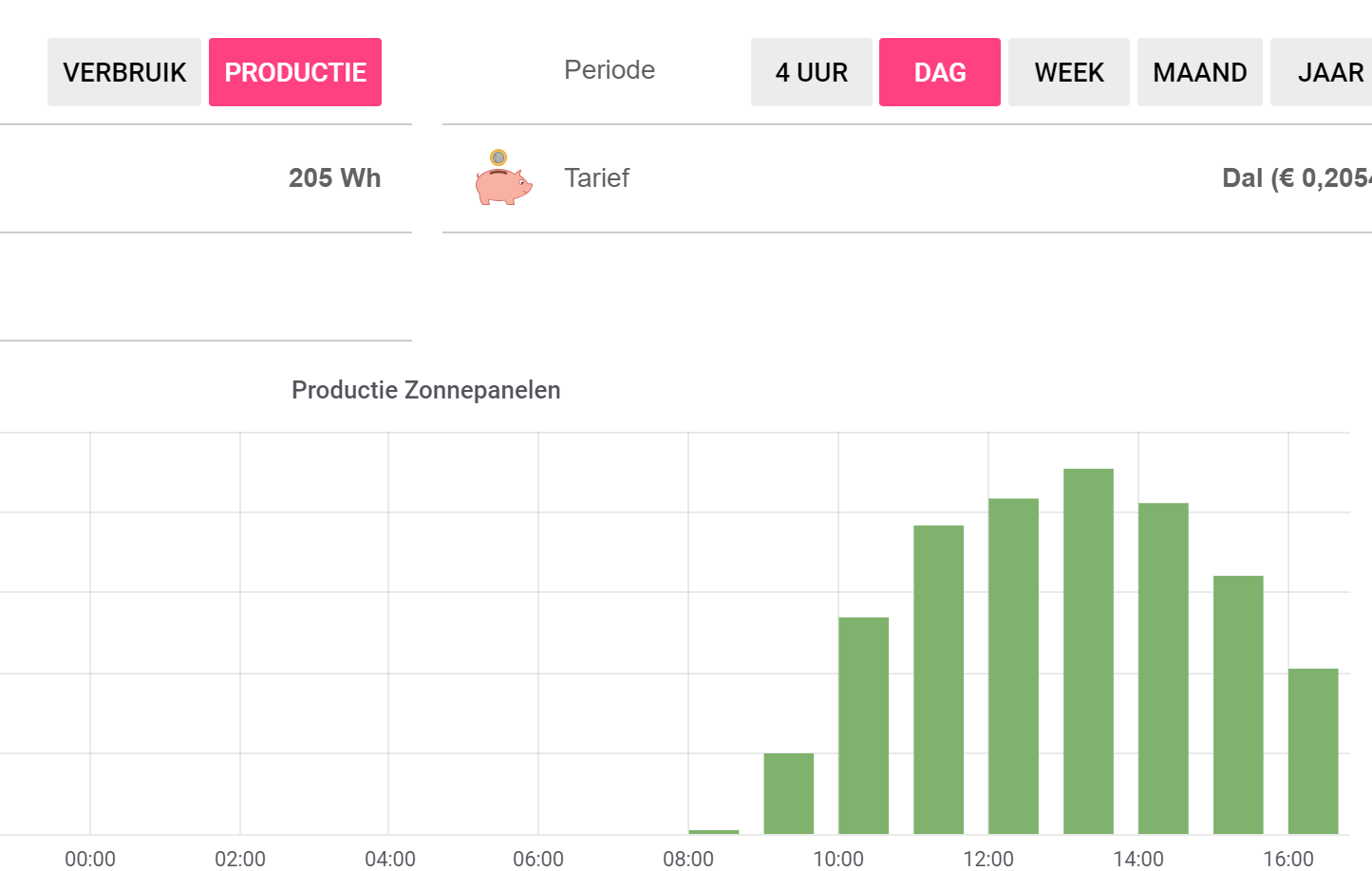

Followed by a picture of the wrong view after selecting a different time range but before manual browser refresh:
