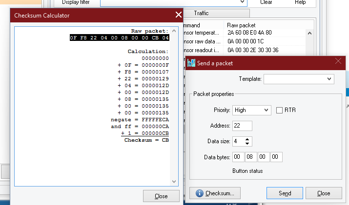

I have tested the following with a button from a VMB8PBU, which was programmed in VelbusLink with a “Up/Down” action on a VMB2BLE motor controller.
Just issuing a “Button Pressed” packet was enough to start and stop the VMB2BLE.
What happens with other modules will be a matter for you to explore.
Here is what I did.
I opened VelbusLink logging and isolated the VMB8PBU packets by using the filter
packet.addr==$A0
Then I Pressed, Long Pressed and Released Button 7 of the VMB8PBU (I did it from within VelbusLink, using the Operate function)
Which gave me this
The first Button Status is the “Press”
Second Button Status is the “Long Press”
Third Button Status is the “Released”
You’ll note that H40 pops up in all three strings, at different places.
H40 is derived from Bin 01000000, which indicated that Button 7 is in play.
So equally, H01 would mean Button 1, from Bin 00000001
By highlighting the first Button Status and clicking on “USE”, followed by “Check Sum”
I was able to highlight and copy the “RAW packet”
This gave me these three HEX strings
Press       0F F8 A0 04 00 40 00 00 15 04
Long press  0F F8 A0 04 00 00 00 40 15 04
Release     0F F8 A0 04 00 00 40 00 15 04

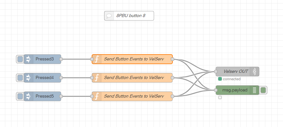

Looking into this further, I discovered that it is possible to use a Function node to format the VelServ packet, and get triggered by different Payload content.
For example, I created a Function node that can output the 3 different button events, based on a payload containing matching text.
Which means that by using a couple of Delay nodes and Change nodes, you could automate the sending of the correct sequence of Button events to correctly match your requirements.
IE
  • Pressed
  • Long_Pressed
  • Released
You will just have to work out the correct sequence of Button Events to trigger your scene and release all modules (IE, Don’t Leave them waiting for a “Button Released” event)
Please note that I have added 2 variables to the Function node so that you can easily adapt it for your use.
  • address
  • button
These need to the the Decimal version of the HEX command you wish to send, whereas the rest of the string you see in the function is made up of HEX .
This might help you a little further

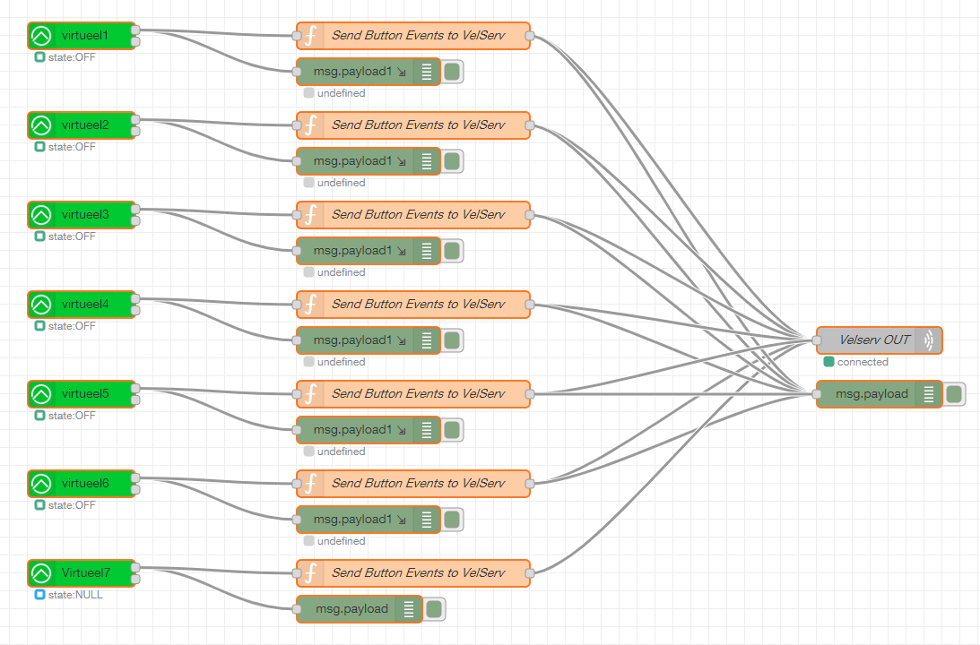

I have now velserv, openhab and node-red working :slight_smile:

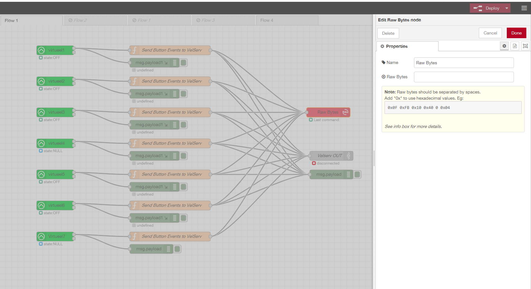

I think there is a little error in your hex codes the 9th hex value is changing depending the adress, or something else (checksum ?).
I 'm now trying to send the press and release command with one press of a button, do you know the correct comand for the delay. (I’m using now “timeout(1000)”)
here you have my node-red export file:
[{"id":"ccfd159f.c0e418","type":"function","z":"d86de69f.3d1a48","name":"Send Button Events to VelServ","func":"var button3 = 4; // Decimal of Hex 40, which is button No 7 only (Different numbers are generated if multiple buttons are pressed). Note Dec 64 is derived from the Binary state 01000000 indicating  button 7\nvar address3 = 34; // Decimal of Hex A0\n\nvar incoming = String(msg.payload);\nvar buffer = \"\"\n\nif  (incoming == \"Pressed3\" )  {\n// Format Pressed event\nbuffer = Buffer.from( [0x0F, 0xF8, address3, 0x04, 0x00, button3, 0x00, 0x00, 0xCF, 0x04] );\n//Timeout(1000)\nbuffer = Buffer.from( [0x0F, 0xF8, address3, 0x04, 0x00, 0x00, button3, 0x00, 0xCF, 0x04] );\n\nreturn {payload:buffer};\n\t}\n\t\nreturn [msg];\n","outputs":1,"noerr":0,"x":650,"y":640,"wires":[["440b7389.4d954c","adf0b974.f17448"]]}]

Yes, the one before last byte is always a checksum and I’ll confess I completely forgot to account for that.
It’s probably best at this stage to see how VelbusLink creates the checksum, by using the steps I showed above.
As for sending a Pressed AND Released msg from the same function call, I suggest you have a read of this page on the NodeRed site, specifically the section marked “Multiple Messages”
I think what you’re doing currently is creating a buffer with the PRESSED string, then immediately over writing it with the RELEASED string.

For example, if you were to press buttons 1 and 4 at the same time, it would look like this
Buttons 8 7 6 5 4 3 2 1
Pressed? No No No No Yes No No Yes
As Binary 0 0 0 0 1 0 0 1
Binary Form 00001001
Hex Form 09
Assuming you mean button 4 and the Decimal base address of 34 converts to HEX 22
Your PRESSED packet might well look like this
0F F8 22 04 00 08 00 00 CB 04
Hi stuart, I have a working solution now, thank you very much for your help.
This is my design in nodered.
and this is the code for one button.
// v1rtueel controls button VMB8PB (adress 22 button 1)
if  (String(msg.payload) == "ON" )  {
    return {payload:Buffer.from( [0x0F, 0xF8, 0x21, 0x04, 0x00, 0x01, 0x00, 0x00, 0xD3, 0x04] )};
if  (String(msg.payload) == "OFF" )  {
return {payload:Buffer.from( [0x0F, 0xF8, 0x21, 0x04, 0x00, 0x00, 0x01, 0x00, 0xD3, 0x04] )}
return [msg];
in openhab I made virtual items and I use in habpanel this widget
When you push the button, the ON command is send and after a few ms OFF is send to velbus.
It is very nice that every scene can be programmed within velbus, and recalled directly from the habpanel. (with fade times, etc)
I still do not find a reason why stef coene didn’t programmed the item “simulate this button” (you can find this in velbuslink to test your actions)
i just have to find a way that all my monstable buttons are in selection button(i have put my buttons in a group), like I have with my sonos fav.
I have problems with running the lastest binding of velbus (witch recognises vmb1ts) and velserv (dsm rules doesn’t work anymore till I shut down velserv).
But I need velserv for my nodered, any idea how to talk to the velbus (usb) via the velbus raw byte node ?
If that is not possible a try a second pi with velserv seperated from openhab
By any chance…
Are you using the Velbus NodeRed nodes?
I believe these are strictly a ‘direct connection’, unless the author has been able to add TCP support.
Update
After looking closer at your screen grab.
Why are you using the Serial Only Velbus node AND a TCP node to VelServ ???
Unless you have 2 Velbus USB connections, this will never work. (And you’d be sending the same instruction twice)
Because VelServ takes exclusive control of the Velleman / Velbus USB port.
Blockquote
I’m not using both at the same time (I disable one when I use the other way), It was for testing because the velbus binding was giving problems via velserv. I think when the binding is working perfect with velserv all my problems will be solved !
