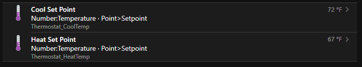

My setpoint values however are being converted from Fahrenheit TO Fahrenheit - meaning my current configured range of “67-72” is showing as “153-162” in the Home app. I’ve tried all sorts of things to resolve this, but can’t figure it out. The setpoint items are configured as Point>Setpoints with a type of Number:Temperature. Similarly, my current temperature item is also a Point->Measurement with type Number:Temperature. I would expect the setpoint values not to get further converted to Fahrenheit again, but they seem to. Changing the types from Setpoint to Measurement has no effect. How can I resolve/troubleshoot this?

I’m assuming that if you take HomeKit out of the picture, that the OH pages DO function correctly?
