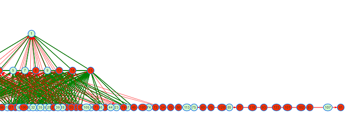

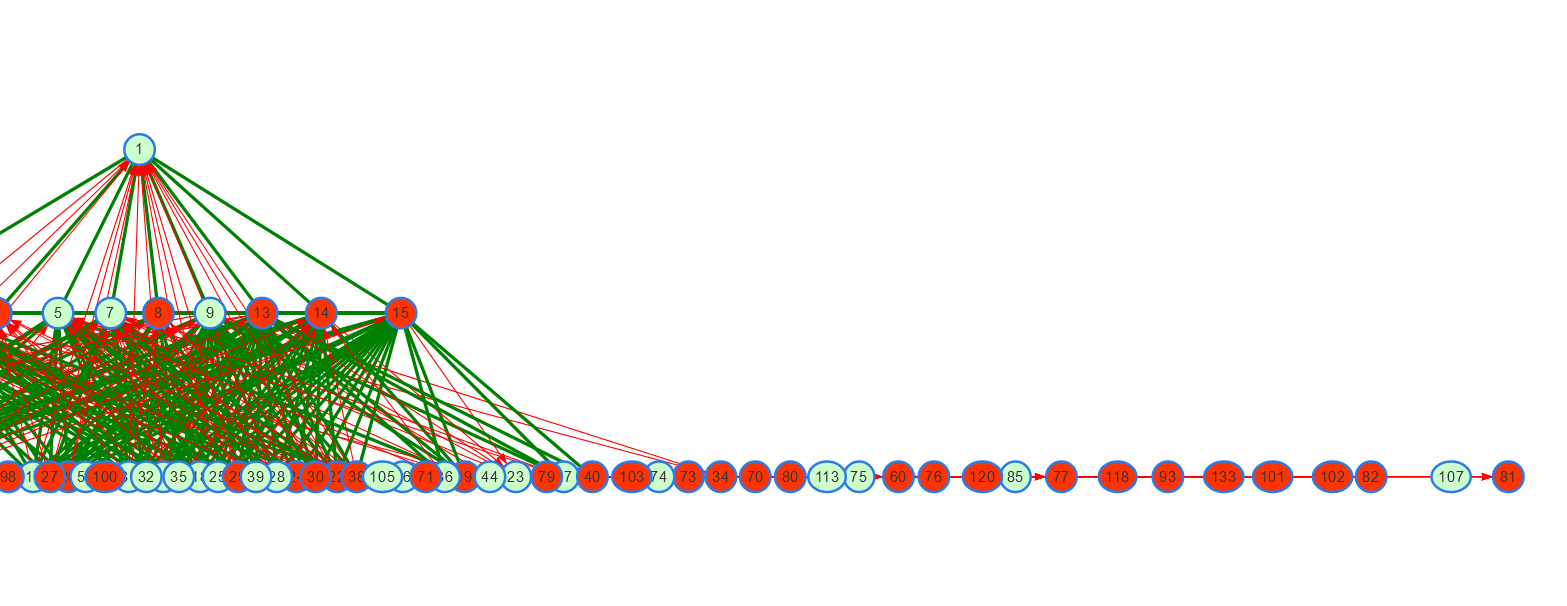

Seeing alot of nodes not talking to the controller, and the map shows nodes yet not forming neighbors.
There doesnt appear to be any major issues in usability, but something isn’t right.

The map shows this after a few days. All of the polling of the devices has been turned off to save zwave bandwidth.

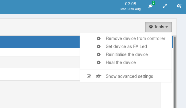

Habmin> Configuration> Things> select your Thing> Tools> Show Advanced Settings> Heal the device
