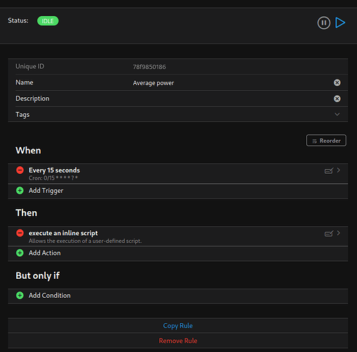

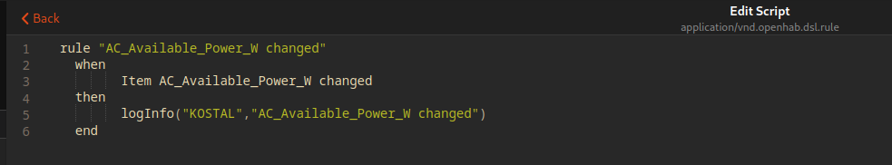

I’m trying to learn DSL rules. I wrote a simpliest one (aka hello world) but the logs tell me that I miss something obvious.
The rule:
configuration: {}
triggers:
  - id: "1"
    configuration:
      cronExpression: 0/15 * * * * ? *
conditions: []
actions:
  - inputs: {}
    configuration:
      type: application/vnd.openhab.dsl.rule
      script: |-
        rule "AC_Available_Power_W changed"
                Item AC_Available_Power_W changed
                logInfo("KOSTAL","AC_Available_Power_W changed")
    type: script.ScriptAction
the log
11:22:01.039 [ERROR] [.internal.handler.ScriptActionHandler] - Script execution of rule with UID '78f9850186' failed:  ___ rule  ___ "AC_Available_Power_W changed"
   1. The method or field rule is undefined; line 1, column 0, length 4
   2. The method or field when is undefined; line 2, column 38, length 4
   3. The method or field changed is undefined; line 3, column 77, length 7
   4. The method or field then is undefined; line 4, column 87, length 4
   5. The method or field end is undefined; line 6, column 151, length 3
   6. This expression is not allowed in this context, since it doesn't cause any side effects.; line 1, column 5, length 30
   7. This expression is not allowed in this context, since it doesn't cause any side effects.; line 3, column 51, length 4
   8. This expression is not allowed in this context, since it doesn't cause any side effects.; line 3, column 56, length 20
The error seems to tell that OH doesn’t even get the “when” line… What I am missing?

Anyway, the solution is this:
configuration: {}
triggers:
  - id: "1"
    configuration:
conditions: []
actions:
  - inputs: {}
    configuration:
      script: |-
In other words, you just write whatever that’s inside the then block into your UI Rule.
What you wrote was meant for file-based rules.
