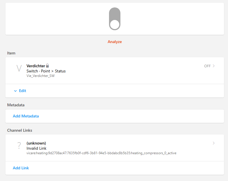

I jost lost the cannel to see if the compressor is active.
Does everyone else has the same issue?
Thanks.
