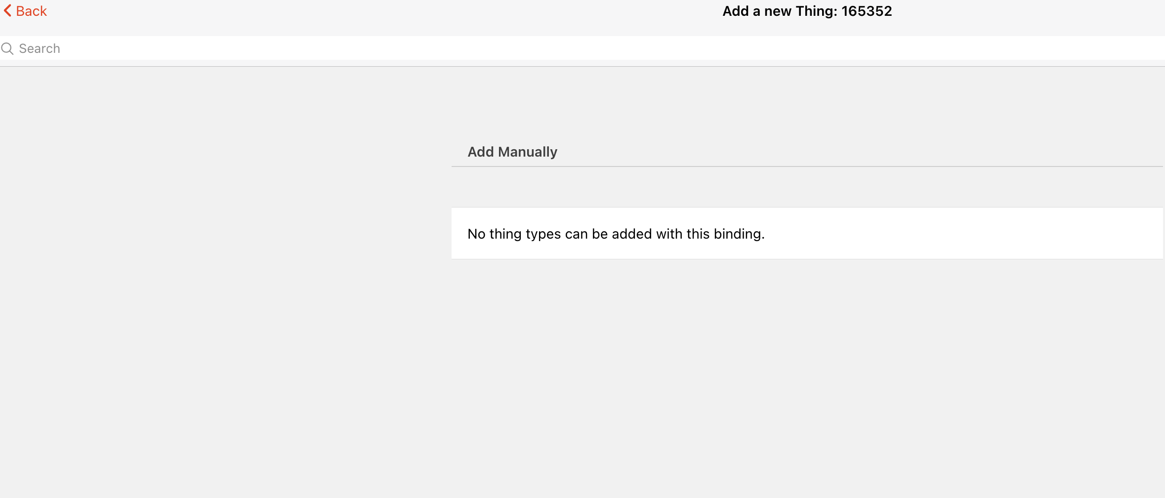

I installed the binding in replacement of the older ViCare-Binding which also used the Viessmann API on Openhab 5.0.
When trying to create new Viessmann Thing it tells me ā€œNo thing types can be added with this binding.ā€ - So how do I create the Viessmann Thing?
Maybe I’m missing something?
You have to create the bridge only. after the bridge comes online, it will autodiscover the things which belong to the bridge.
It seems, removing and reinstalling the addon solved the issue.
Thanks.
