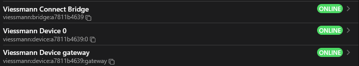

I have a gateway thing, a connect bridge thing and a device 0 thing. Am I missing an account thing?

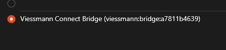

As far as I understood I should switch the device 0 thing from the bridge to the gateway thing. However, I cannot pick the gateway thing. If i click on the bridge line in the device’s setting I only get:
So what am I doing wrong?

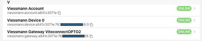

@sven1234

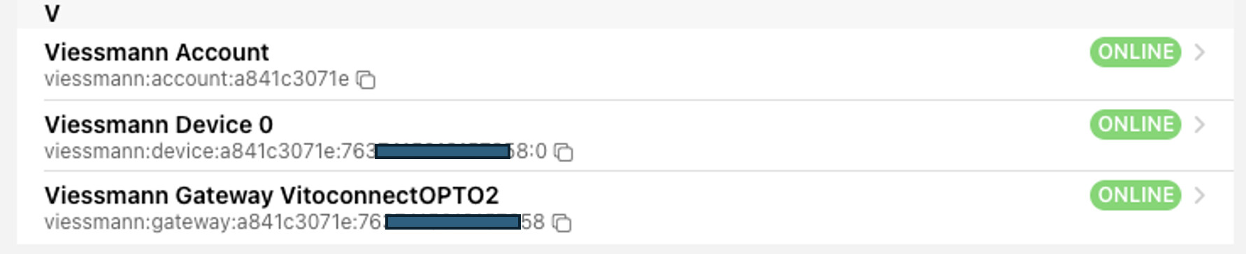

You need the account thing to discover the gateway (viessmann:gateway:xyz) and not the gateway device (viessmann:device:7811b4639:gateway) ← this can be removed. After the gateway is discovered and added the thing, you can chose it on your device 0.
To add the account thing. Use the + sign to add a new thing. Chose the Viessmann binding and add the account thing.
After that, it looks like this:

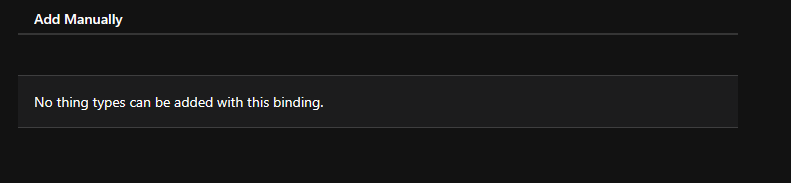

Only shows this:

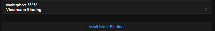

Please try these steps:
  • Remove the binding
  • Check in the console if there another version is installed bundle:list -s | grep -i viessmann
  • clear openHAB cache
  • Re-install via the marketplace
That worked, thanks. Now it discovered and offers device 0, which I already have and switched to the gateway. So I guess I have to ignore that duplicate discovered device.
Yes, you can ignore the new (duplicate) discovered device.

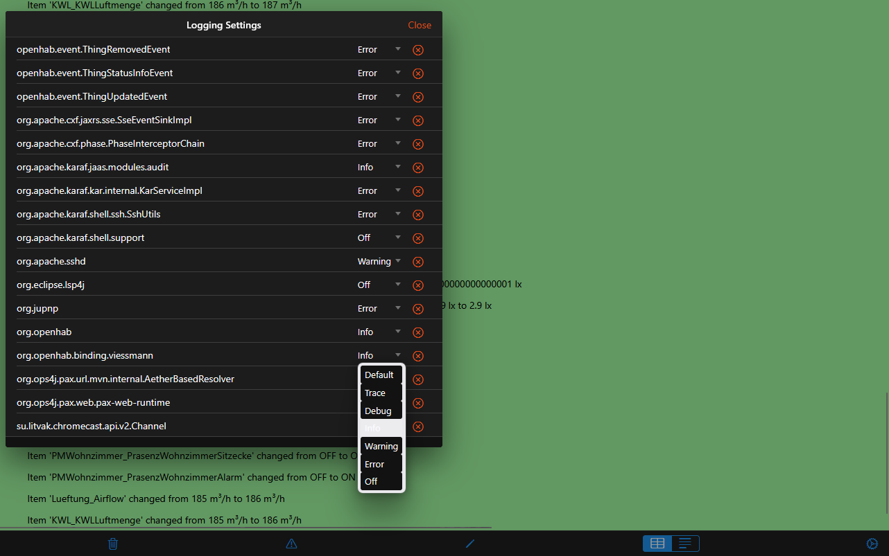

If one uses the little gear at the bottom right in the logviewer which is included in openhab, one can also set the loglevel without accessing the console:
