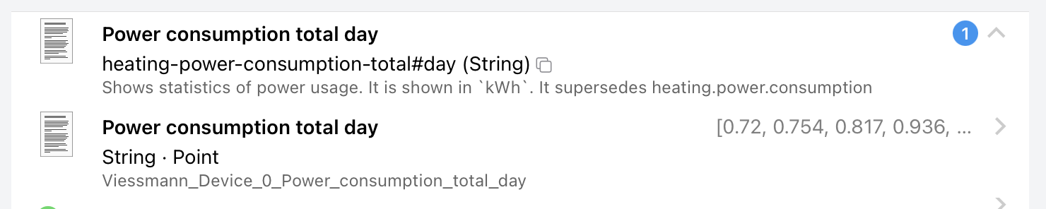

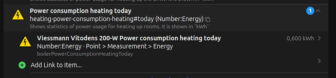

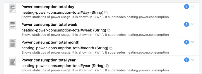

I finally migrated to your new add-on. Unfortunately some Channels for power consumption seem to deliver no values to the Items. Power consumption heating is working, Power consumption water and total are not working. Just tested values for today. Might be the same for yesterday, and so on.
Maybe my power consumption for water is too low to be displayed.
Can you help? Thank you in advance.
Hi @cweitkamp yes this is possible. Can you please send me the API response (in TRACE mode) via PM.
I’d like to analyse the original values from the API

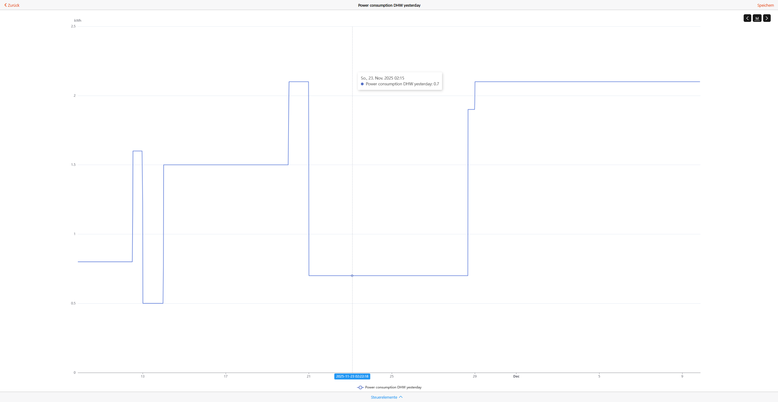

So having no data for this-month that i am able to represent in a chart i tried to build the data for the aktual month with a rule emptiing an additional item at first of month and than adding every day at 00:01 the data from yesterday to those items.
The problem that arose is the most of the time all day channels don’t update as they should.
To illustrate i added power consumption dhw yesterdays as chart for the past month so you can see that the data the channel provides isn’t usable.

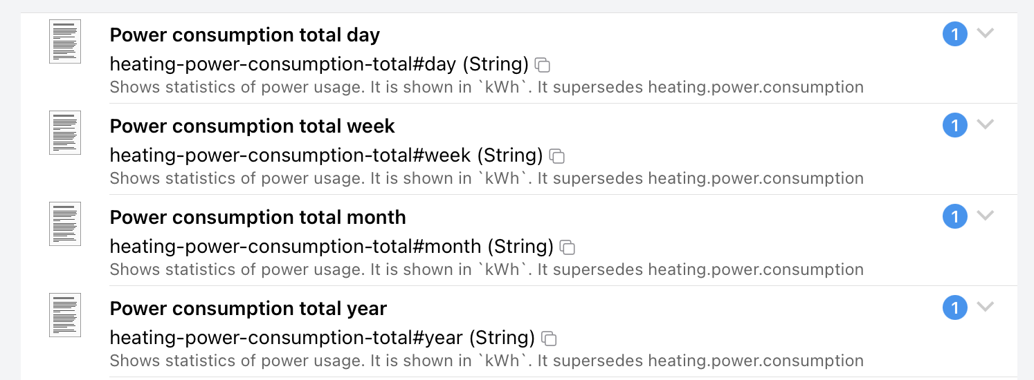

Hi @Sysiphus These four channels contains the RAW data in an array from viessmann API
For example:
The first value (0.72) is the current consumption for today und the next (0.754) for yesterday and so on..
On my system, the values ​​match those in the ViCare app. I think there is something wrong with the provided data from the viessmann API.

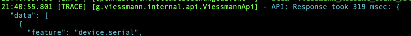

For further analysis please send me your log in TRACE mode via PM. I need the complete API Response wich starts here:
I will take a look at your log and search for the cause.
