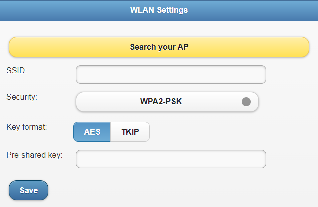

I’ve been trying to connect the Vivint doorbell camera to my wifi network.
I am following the guide by Paulo (figorelli)
After resetting the doorbell/cam it appears as a wifi network VIVINT_DBC_({mac_address})
After connecting to it, and navigating to 192.168.1.1 the browser shows the WLAN settings page (see the screenshot below)
I can hit a button ‘Search your AP’ and select my Wi-fi network.
I am selecting WPA2-PSK which matches my router settings.
I selected ‘AES’ as the key format.
The last item is ‘Pre-shared key:’ which defaults to a series of zeros.
I tried just entering the wi-fi password, but when I hit save, the doorbell cam never connects.
The doorbell cam wi-fi is not longer available at this point, and I have to reset the doorbell cam by holding the button until the LED turns a red color. Then the doorbell cam’s wi-fi is back, and I can try again.
Don’t know much about this, but as understand it the ‘Pre-shared key’ PSK I guess, isn’t the same as the wi-fi password.
My router is a tp-link AX5400.
It has a search option, and when I search for ‘Pre-shared key’ it appears in the list of search results.
However when I click the item it just takes me to the wi-fi settings page. On that page, I can’t find any reference to a ‘pre-shared key’ even after playing around with the options.
Hopefully an expert here can help, I feel like I’m very close, but not quite.
Okay, I got it to connect.
Turns out that the ‘pre-shared key’ is the WiFi password.
The solution seems to have been to cut power to the doorbell for about 30 seconds.
After that I repeated the steps and it connected immediately.
