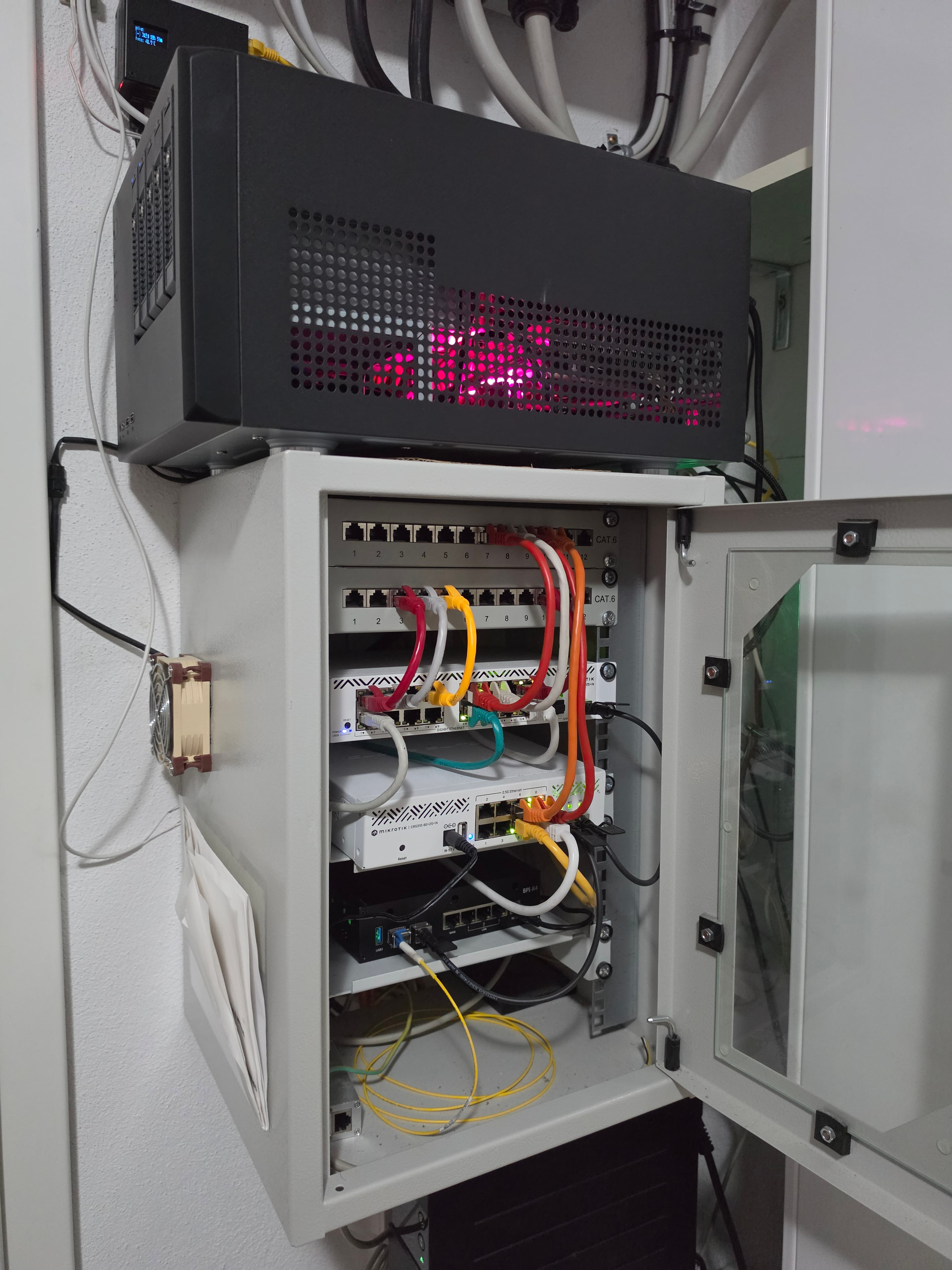

my server is connected by default with vlan 1 and with virtual interfaces with vlan 2,3 and 4
on my server itself, everything is visualized. Means all my services, including openhab running as separate containers. Currently there are 34 containers in total. The underlying os does not matter. I can deploy my setup on suse leap 16, alma 10 and latest ubuntu. But currently I prefer suse, because I’m using it since 1995 and I’m feeling a bit nostalgic with it :slight_smile:
this is my setup
