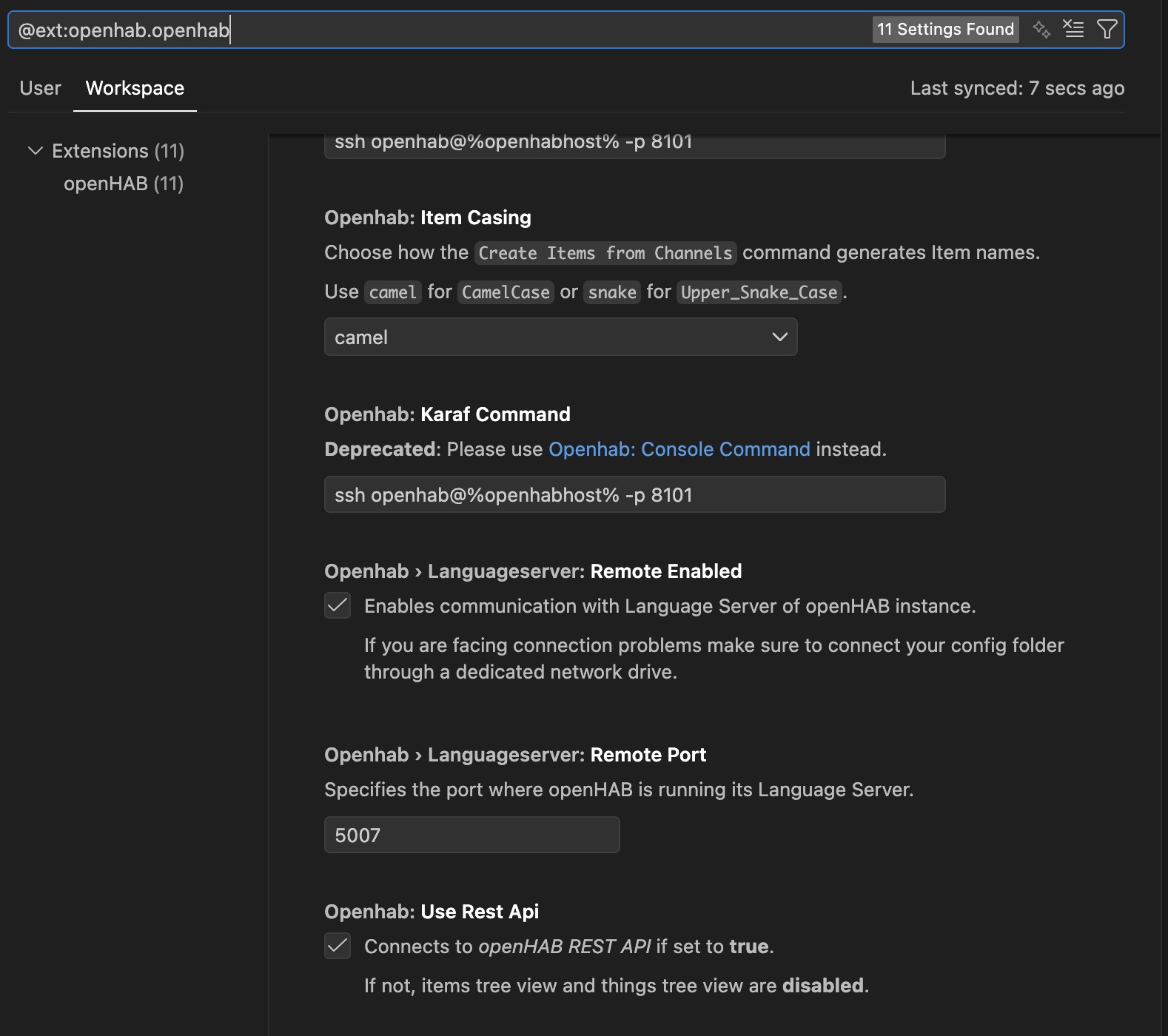

I have deleted all global (User) connection settings and left only the ones at the Workspace level (.vscode/settings.json), as suggested in VS Code OH5 - Error while connecting to openHAB REST API. I also tried the other way around, with the connection strings in the User configuration, to no avail.
"openhab.connection.host": "10.18.18.102",
"openhab.connection.authToken": "oh.VisualStudioCL.a0XXXXXXXXXXXXX”,
"openhab.connection.port": 8080
The other settings are not in the textual configuration, and adding them there doesn’t change the outcome.

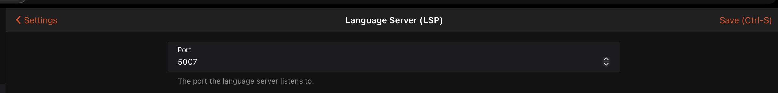

On OH, the LSP is listening on the same port:
