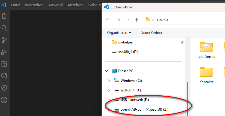

I have a Windos-Machine. And even if I have Samba-Shares for use with ssh.
To use VSC from my Windows-Machine to get Acces to my OH-Folders I have to connect my openHAB-Pi as a drive to Windows

Please be sure to mount the network share to a drive letter.
Please mount only the openHAB conf folder to that drive letter!

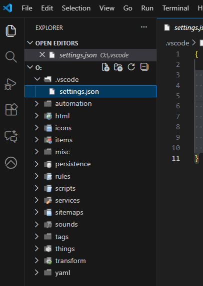

I strongly recommend to use only the workspace settings, not the global settings. Comment out all settings in your global settings.json.
Then create in your openHAB conf folder a hidden directory .vscode/settings.json
Copy your settings to that file, don’t forget to create the token, here is another example:
    "openhab.connection.host": "192.168.2.212",
    "openhab.connection.authToken": "oh.restapi.yourSecretToken",
    "openhab.connection.port": 8080,
    "openhab.languageserver.remoteEnabled": false,
    "openhab.languageserver.remotePort": 5007,
    "openhab.useRestApi": true
Now open the drive letter in VSC and you should see all files needed.
