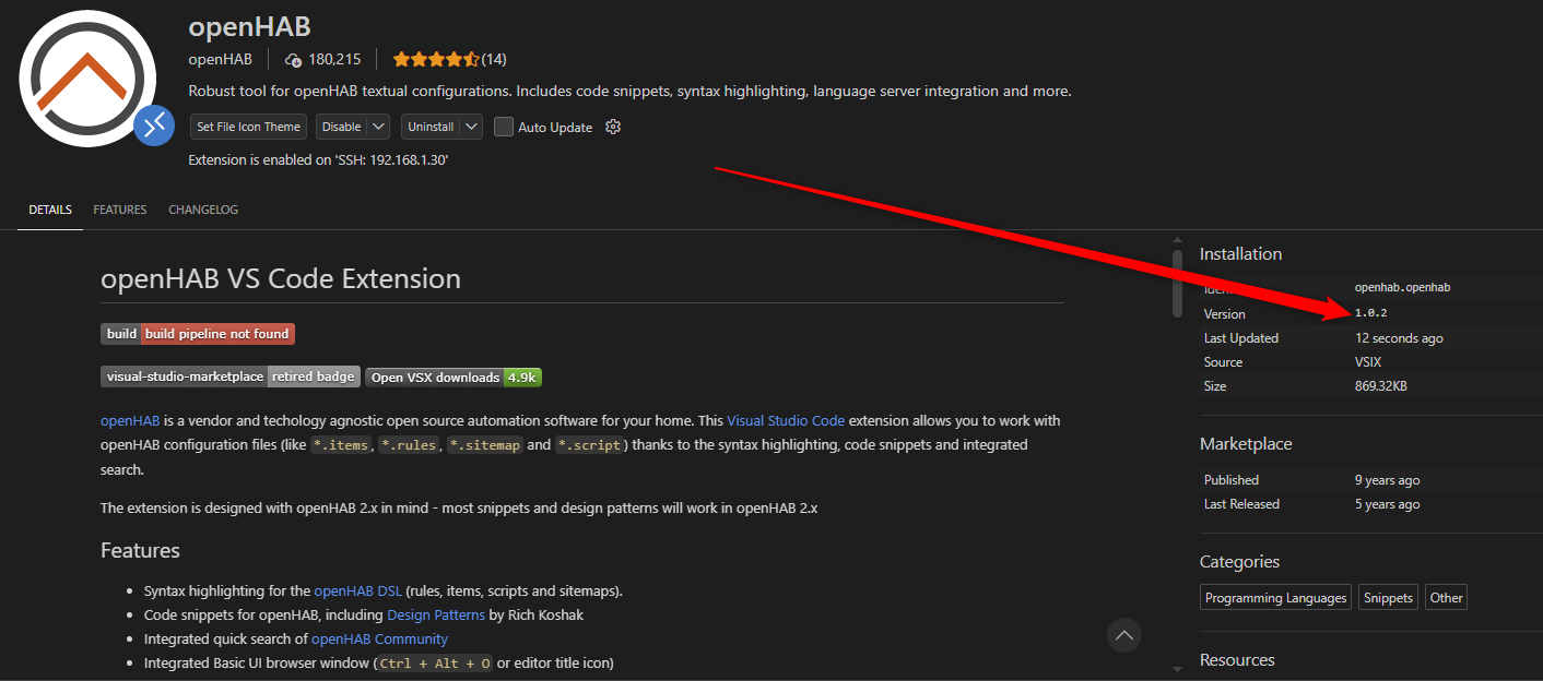

They do for me. But never mind, I updated the extension a little further so it now shows also references. Means: you hover over an item in a script and it shows where it is defined (items file ) and where its used.
Its configurable and all. I bumped the version to 1.0.2 so you can check if you actually run it.

After updating from 1.0.1 to 1.0.2 I get the following error in the Output screen
openHAB vscode extension has been activated
Could not reload items for HoverProvider
    Error:
        Error while connecting to openHAB REST API.
    Message:
        Request cannot be constructed from a URL that includes credentials: http://xxxxx:yyyyyyyyy@192.168.2.167:8080/rest/items

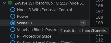

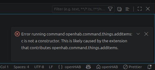

I’ve found a minor bug in VSC extension 1.0.2:
when trying to “Create Items from Channels” on a Thing
Auswahl_002
I get this error message:
Error running command openhab.command.addItems: c is not a constructor.
This has worked before.
When I try to do that on a single Channel of that Thing, it does work, though:
As said, only a minor issue …
