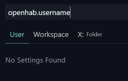

I had the issue with the extension showing me an error about depreciated configuration too:
However this is not configured anywhere:
I also searched in the settings.json and could not find the setting.
Reloading the window (as shown in the GIF) didn’t help either.
Strangely enough I was able to fix it by just adding the new property to the settings.json:
"openhab.connection.basicAuth.username": "" and the extension did not complain anymore
Same what happened to me. @Confectrician I think that’s still a bug (and unrelated to caching as I had this issue across many restarts)

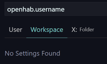

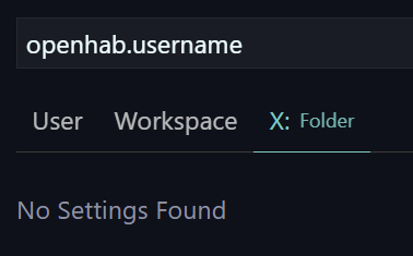

Maybe you have some settings in:
\openHAB-conf\.vscode\settings.json
on openHab server and not in VSCode itself.
I looked there too but it wasn’t defined there either. What about you @mstormi
same

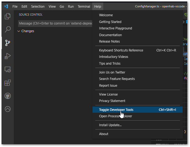

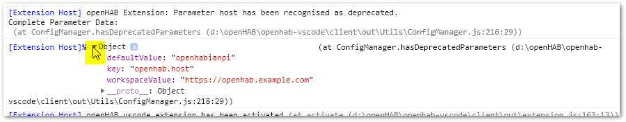

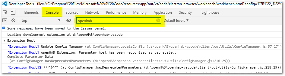

It will add some more logging to the Developer Tools (because i don’t want to make a messy output. No one reads all of that.)
Can be viewed with the following steps:
Open Developer Tools
Go to Console and apply openhab filter:
Look for following log message types and expand the config info with the little arrow:
This will show what vscode knows about the “deprecated” setting and i am able to see where the warning is coming from.
The output may be different from this simple example, depending on the way your configuration is set up.

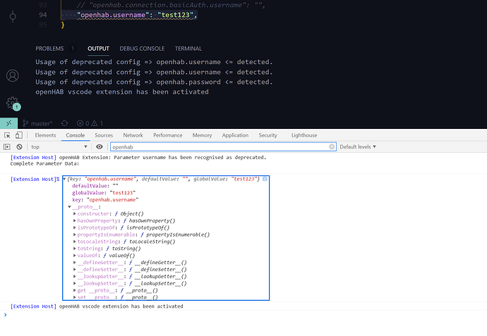

for testing purposes I defined "openhab.username": "test123", in c:/Users/.../AppData/Roaming/Code/User/settings.json. The output looks like this:
Are these the values you were looking for?
The values are fine, but i would need some real world examples, when the bug is occurring.
Then we would have to track down which setting is causing the warning to appear.
