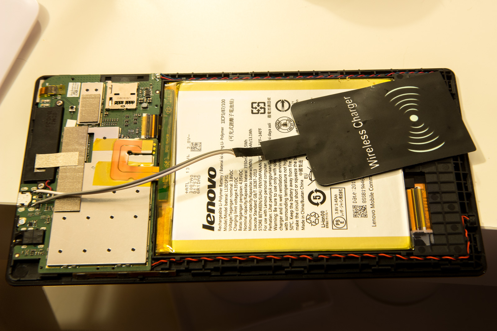

This is how I did wireles charging on cheap lenovo tablet. I opened it and solder the module directly to usb

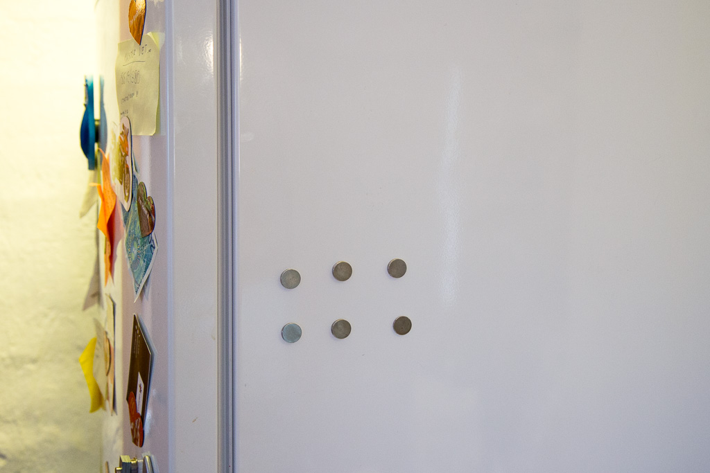

and positioned 6 earth magnets (1mm thin from ebay) in the cover of the tablet (keep good distance between charging module, it can interfere). And put the magnets on the charging board
On the photo you can see magnets from outside, but there are magnets inside as well, increasing the magnets strength. But they hold tablet with no problem at all. Then I mounted the base on the wall.

Good solution I did the same however with Lenovo Tab2 a10-70 10" but instead of soldering QI receiver I used dedicated case, cut off front cover and placed receiver on the back of the tablet. Since it is 10" there is an issue with QI charging efficiency. For example QI charger does not keep up with charging the tablet when I put MJPEG stream as the half or full screen picture in HABpanel.

The charger is the cheapest from ebay or banggood/dx.com, dont’ have the link but it was not some special model, just search for similar looking one. To open a tablet I used plastic tools for phone repair or whatever it is called on ebay. But any sharp plastic will work fine. It is a cheap tablet thought, I am sure some of the more expensive could be more challenging to open, this one worked fine. I tried first with one samsung tablet, but that could not be just plugged to 5v, needed special cable with resistors and several pins connected at once, so I just sold that samsung and purchased lenovo (it is important to have mini or micro usb charger, not some fancy 15pin or something).
Regarding the magents, I purchased some thinnest magnets that are ~16mm in diameter. If you buy the thinnest magnets you can always stack two of them if there is space. I could stack two on the lower side where is battery, but only one on the top side. Magnets are very strong anyway, so if needed you can always stack few more on the charger side.
To position them I just used thin double tape and glued them on the case, closed the tablet and then aligned it with the charger, here it is a bit tricky to find the position where tablet is charging fine (as it takes 1-2s for confirmation) and then just allow cover magnets to snap in place. Test as much as possible (consider the gravity as well) before assembling all, as it is very easy to missalign the charger modules, few times I had it assembled and it would fall down just a millimeter and tablet would stop charging. That is very annoying, especially if it starts making the “plunk” sound when it starts/stops charging.
Easiest to adjust charging is by opening the charging plate and moving the coil inside it a few millimeters and then holding the tablet in the air to test. Best is to try to move tablet a few millimeters up and down to see if it is in the range of the charger.
