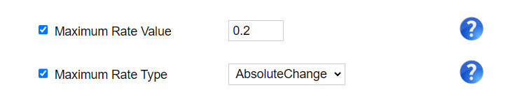

There is already a setting in watermeter configuration for this:
Parameter <NUMBER>.MaxRateValue
Default Value: 0,05
Maximum allowed change between two readings, if exceeded the last reading will be rejected. Depending on the settings of <NUMBER>.MaxRateType the MaxRateValue is either treated as the difference between the two measurements (AbsoluteChange = difference) not taking the set time interval into account or as the difference normalized to the interval (RateChange = difference per minute).
You need to adapt the settings according your water consumption.
