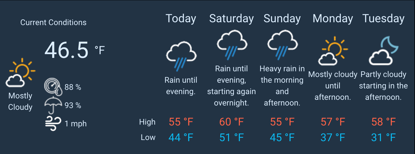

Would you be able to share this widget, please?
It’s actually based off this guide. Weather widget example
I had to make some minor CSS changes, and put my images in a different place…
just use that guide, download your images and put them in them in the html folder (your path will look like
html/images/underground/(your pngs go here)
then I just added some css to alter things a bit to fit my scenario.
<style>
table { table-layout: fixed; }
#weather-forecast-table {width:100%;}
#weather-forecast-table td { width: 20%; }
#weather-forecast-table .col-xs-4 {font-size:19px;}
#weather-temp {font-size:40px;}
#weather-temp-sign {font-size:20px;}
#day {font-size:20px;}
#weather-temp {padding:10px;}
</style>
still messing with it a bit. css is far from where I want it, but it’s a start.
oh I also had to change some of the downloaded PNGs naming to match the code.
