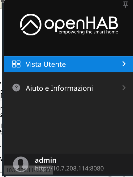

I’ve upgraded from 3.1.0 to 3.2.0.M4 now I can see items from console but web ui management is missing, can see only overview and custom pages runtime.
openhab> users list
openhabian (administrator)
Anything I can do to restore the menus?

Did you log in?
Yes, I’ve access from both console and web.
But on web the menu are missing.
[ EDIT ]
I’v added another user admin, but this one can’t see objects:
openhab> users list
admin (admininistrator)
I’ve successfull login as openhabian user and can see everything.
Are there special permission that need to be added to new users?
Thanks, BR
