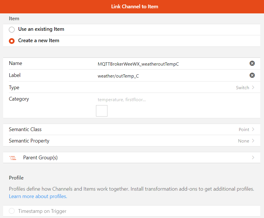

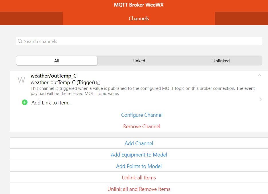

Regarding the WeeWX MQTT Manual https://github.com/weewx/weewx/wiki/mqtt#how-to-verify I have created a channel:
I can’t create the link to the channel, as there is
no profile available for the selected item
:Then I have created MQTT Thing, which is using MQTT broker upper:
UID: mqtt:topic:3d1084e2d9:4a34779f9e
label: WeeWX MQTT Thing
thingTypeUID: mqtt:topic
configuration: {}
bridgeUID: mqtt:broker:3d1084e2d9
channels:
- id: weather_outTemp_C
channelTypeUID: mqtt:number
label: weewx/outTemp_C
description: ""
configuration:
stateTopic: weather/outTemp_C
The channel under it is not getting any data and has always status NULL.
What should I do to make it work? I can see that the WeeWX MQTT server is running and publishing all the data, also the weewx/outTemp_C
topic
