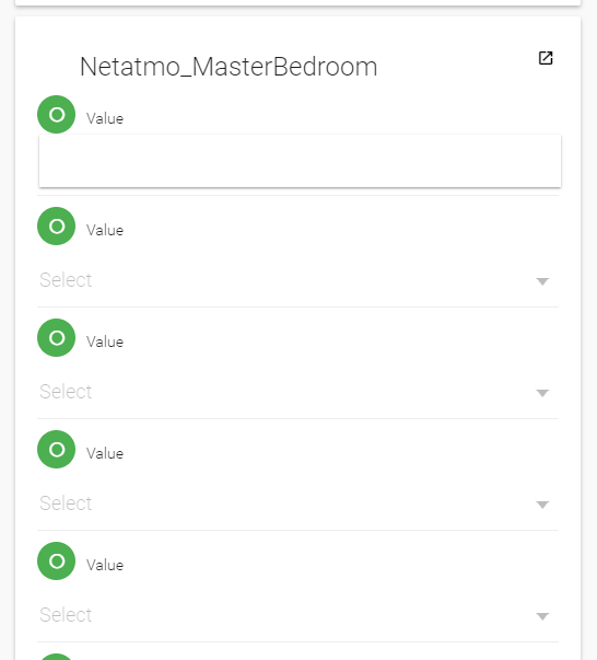

Since the upgrade, when I load PaperUI, my values are not loaded anymore:
Any idea what the cause could be? And more importantly: how to solve it?
Hey Dries,
thanks for reporting. Now that you say it: I remembered that I saw something similiar like this in my logs before. So I looked into them and found the same NPE from time to time. My productive environment runs openHAB 2.1.0 - release build - and the warning looks like this:
2017-08-21 12:32:14.893 [WARN ] [pse.smarthome.core.items.GenericItem] - failed notifying listener '[org.eclipse.smarthome.core.persistence.internal.PersistenceManagerImpl@165b978, netatmoOutdoorTempTrend, null]' about state update of item java.lang.NullPointerException: {}
But I guess this is only a partial error of the Netatmo binding. I am going to report an error in the ESH repo and do some investigations in the binding itself.
// EDIT: issue #4104
