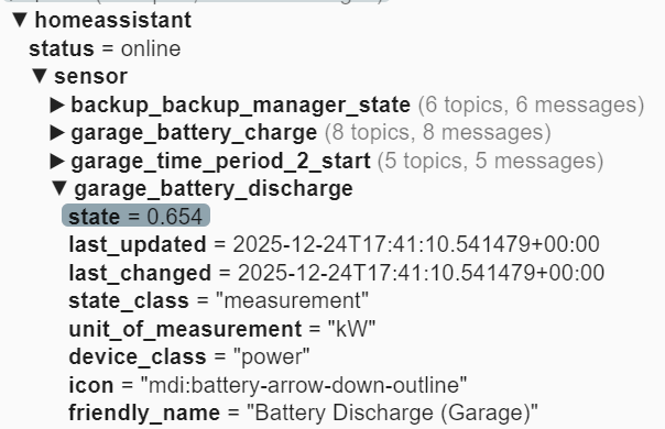

I’ve created a thing to represent the inverter MQTT data and have added a channel but can’t seem to configure the MQTT state topic and incoming value transformation correctly to read any data. For example, the battery discharge rate looks like this in MQTT explorer:
homeassistant/sensor/garage_battery_discharge/state
I want to get the state value, in the above screenshot it’s 0.654. I’ve set the incoming state topic to:

Not sure you need a JSONPATH transformation there. Try setting your state topic to:
Assuming you are using a Generic MQTT thing, create the item as a number type with UOM kW.
A-ha! That fixed it! I’d tried every combination of dots and slashes in the incoming transformation except for having no transformation at all.
