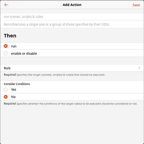

So you just need to create a second rule the entire purpose of which is to run the first rule while ignoring the actions:

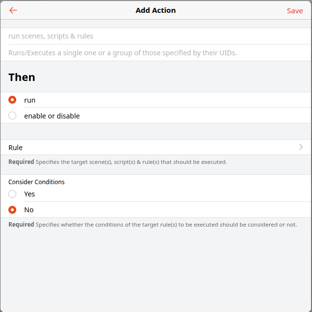

If you make the rule in the UI, you just have to make sure to select No in the “Consider Conditions” field.
Once you have that second rule, you can trigger it however you wish: going to the rules page and pressing play, setting up a widget that runs the rule, triggering it with an item that you change manually, etc.
