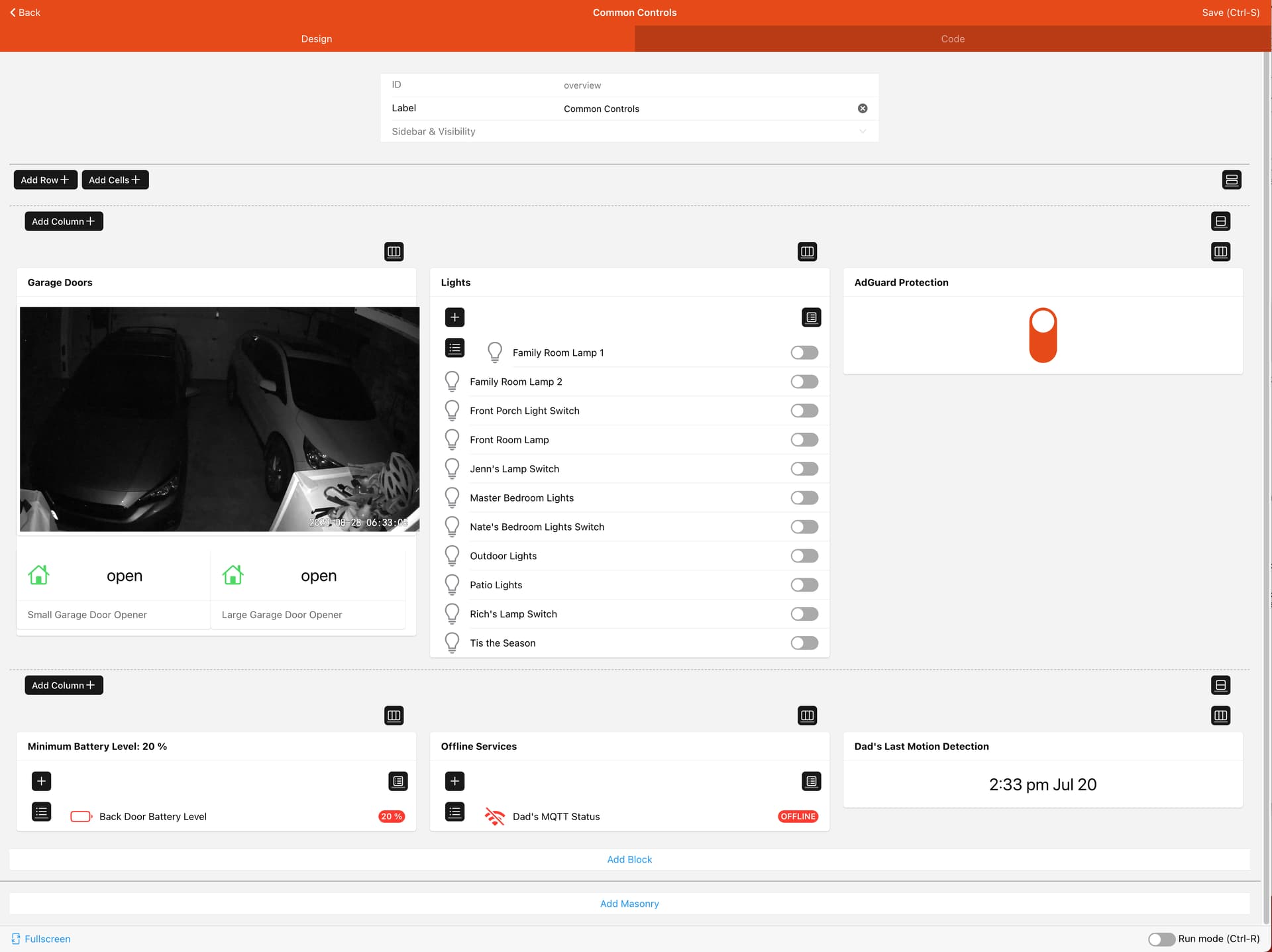

That’s not how you build a MainUI Page. Building a MainUI page looks like:

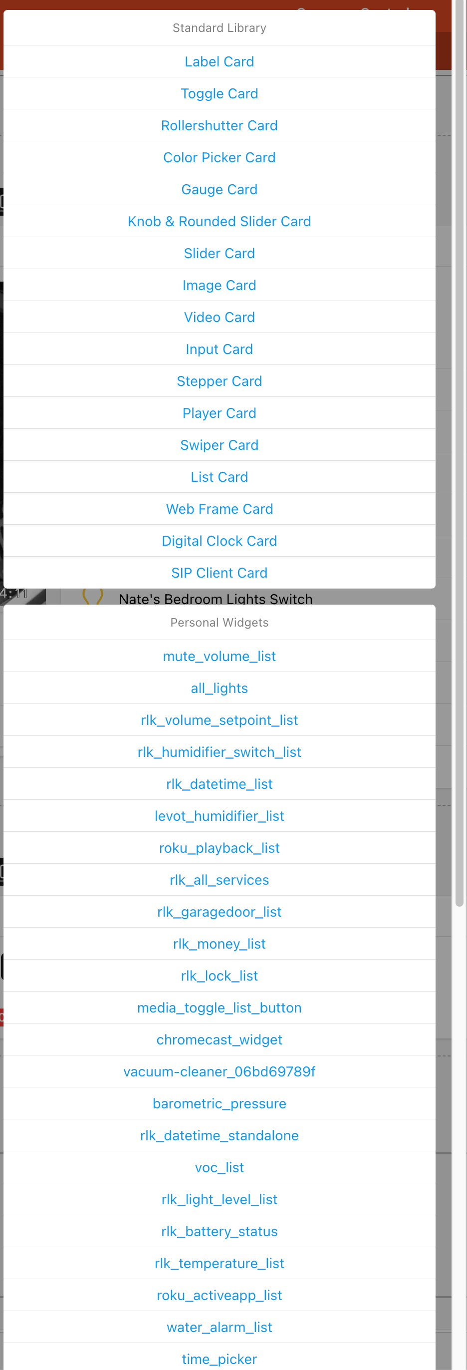

where you have masonary, columns, rows, blocks, cells, and widgets. Here is my list of usable widgets:
It looks complicated but it really isn’t. The masonry, columns, and blocks is just a way to create a space for a widget to live and the only reason my list of widgets is so long is because I have a lot of custom ones.

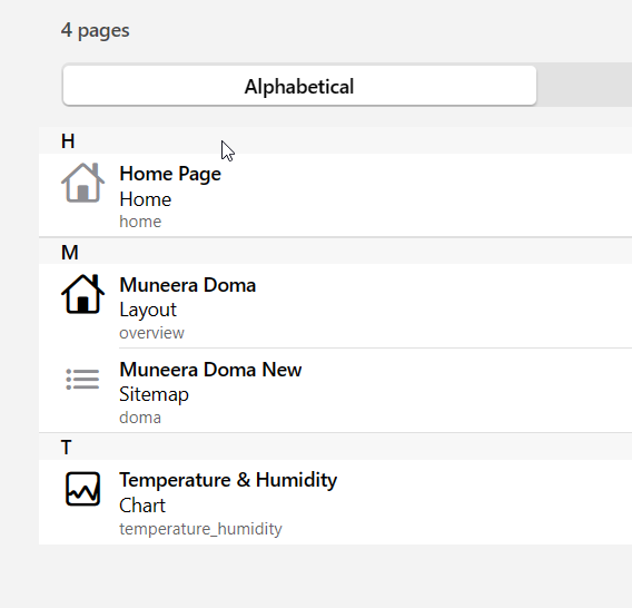

yes, I’m aware the differences between mainui overview and sitemap, i have build semantic model and built an overview page.
i was just asking can I import my old sitemap here in this GUI so i dont have it in the files, but manage from here, and that question was answered, yes it can be copy pasted so great.
