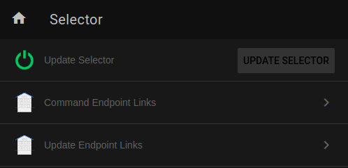

@Dibbler42 I did bring option 3 to life!
It is written for Jython though, so you’ll have to have that installed. I also currently don’t have it published anywhere but I can fix that if you’re interested.
Basically you have 4 groups that you put items in:
  • Command Endpoints receive commands and send them to the real device.
  • Update Sources provide updates from real devices.
  • Command Sources are virtual items that provide commands.
  • Update Endpoints are virtual items that receive updates.
Generally you will have a Command Source and Update Endpoint set to the same item, likewise for Command Endpoint and Update Source, but the option are separate so you have the flexibility.
Then the rule runs periodically and checks for items in those groups and generates a sitemap with all of the link items. Each item in the sitemap provides a selection list of all the items it can be linked to.
During refresh it also creates a rule that is triggered by commands and updates to each type of source. When one of these rules fires it looks for the appropriate link and forwards the event.
In order for the links to be retained, you can provide the name of your persist restore group to the script. Alternatively you could modify your persistence settings to restore the links group at startup.

Indeed, my solution was not designed for this purpose. I built it so be able to repurpose the smart plugs I have that can be used anywhere from a UI.

I forgot I had submitted it as a community script to the helper libraries long long ago. You can see Selector by comparing the branches.
It will generate a sitemap called Selector that looks like this:
@Dibbler42
I have to check that very carefully, but it look impressive.
