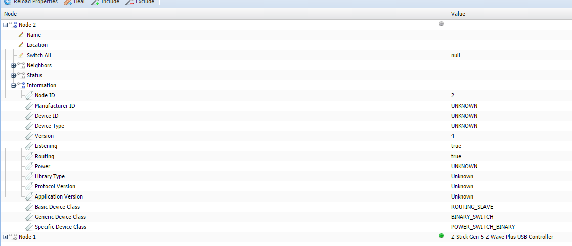

I’m trying to get my first z-wave stuff going.
I did the pairing correctly I think, and habmin is showing the device but it’s just showing unknown for everything. The device is a Aeon Labs Aeotec Smart Switch Gen5 ZW075-C07 which I don’t think is in the database so I suspect I need to do something, but shouldn’t the node show a device id?

The values have changed a lit bit if that matters. I’ve also moved it closer to the control stick.
