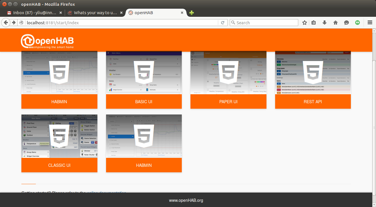

@chris and @xsnrg
I tried below steps to update OH2, but sometimes face problem.
1 Habmin stay still the old version.
2 within Habmin, can not see items which are defined in demo2.sitemap.
$mkdir hab down
$cd hab
$rm -rf /tmp/
$rm -rf /cache/
$cp /conf ./ -dpR
$cp /userdata ./ -dpR
$cd ..
$./makeHAB (this is your script without the designer part located at
GitHub - xsnrg/OpenHAB2-tools: various scripts and hacks to assist with OpenHAB2)
$cd hab
$vi conf/services/addons.cfg
$./start.sh
Basically,
1 I copy userdata/ conf/ directory under old OH2 to hab/.
2 run makeHAB which is your script
3 edit addons.cfg
Please correct me if I do something wrong and please give some suggestion if possible.
Thank you very much.
Re: HABmin version
I haven’t done this yet, but I suspect that you will need to delete the existing habmin jar file from the addons directory. You may need to do this before you update to the latest build, but not sure.
Then restart openHAB and install HABmin from the Paper UI.
I did it this morning, and you are correct. Delete from addons directory, and install using PaperUI, or add to your conf/services/addons.cfg file before you restart OH.
Thank you for your idea.
1 I got if deleting habmin under addons/ and restart.
1 Should I do this?
# A comma-separated list of UIs to install (e.g. ā€œbasic,paperā€)
ui = basic, paper, habmin
2 However, I manually copy here
3 I can not find habmin in my paper UI.
Thank you.
Yes. This is what I have in my addons.cfg
When you ran makeHAB, are you sure it deleted the userdata/tmp and userdata/cache directories in the main openhab directory?
Yes.
But never mind, it seems work by manual copying. Thank you, though.
I think you are saying install by PaperUI or add to your conf/services/addons.cfg file instead of both of them.
However, one thing is not reasonable to me is that another binding called orvibo, which I also add into conf/services/addons.cfg, is installed automatically without touching PaperUI.
However, same thing does not happen on Hambin.
Thank you.
