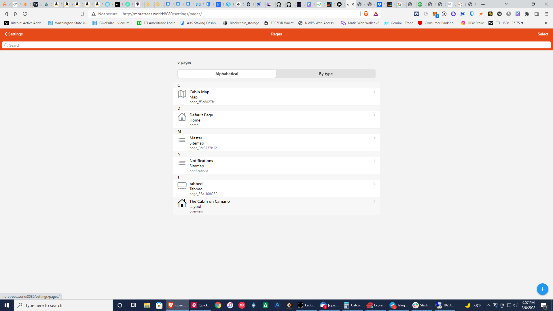

Let me try to explain more clearly: I access by typing moretrees.XXXXX:8080
This gets me to the user interface that I am happy with. What I don’t understand is where that is set and how it knows to launch that “page”. This screen shot shows the list of pages — moretress.XXXXX:8080 launches the one called “Cabin on Camano”, which is what I want but I do not know how it knows to use that one. It must be set somewhere but I don’t know where and have been unable to find where it is.
Sorry, I am sure this is SO basic, but I am having a hard time connecting the dots.
That is the one with the special identifier overview. As Rich said, that’s the default option. But it’s not the default option because of some setting. It “knows” to load that page because all the pages are dynamically built and the UI is hard-coded to present the home page with the tabs that include the semantic information (locations, equipment, and properties) and the overview page first. You can’t change that behavior. There are work-arounds for some special circumstances such as the thread that Oliver gave the link to, but again, that’s not changing a setting that alters how the UI works.
