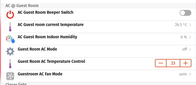

I have Haier, works perfectly. I switched its original wifi module with a esphome firmware.
I would say AirZone but then again that’s because I wrote the binding for it. And it might not be available in your country anyway.

It was merged into addons awhile back. Don’t recall exactly, but added a dehumidifier this year. Only caution is there is some variation in models, but so far have been able to adjust to handle.
I recently connected my Midea using the Matter binding. It supports a few basic functions such as on/off, setpoint, and running mode
