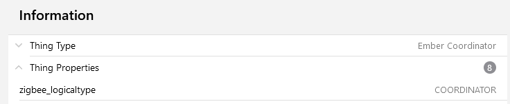

Check the Zigbee firmware version of your HUSBZB-1 as soon as it arrives. To support Zigbee 3.0 devices, the firmware version of your HUSBZB-1 should be 6.7.8 or higher (IIRC). Of course, the firmware of your HUSBZ is upgradeable. Not sure about the Z-Wave part of the firmware, but it seems to be upgradeable too - albeit with a somewhat higher risk to kill the stick:
Additional hint:
As soon as you are satisfied with your solution, don’t forget to backup the Z-Wave part of your stick and order a spare HUSBZB-1. :slight_smile:

I also use the HUSZB and use it with the native openHAB Zwave and Zigbee bindings. I did upgrade the firmware (instructions are in the Zigbee docs) on it so it supports a newer Zigbee version but it’s still a 500 series Zwave controller. I’m very happy with it.
My understanding is that zigbee2mqtt only works with a very small set of Zigbee controller using a Texas Instruments chipset. The HUSZB uses and Ember chipset so I don’t know if it would work.

Depends on your definition of “very small”. The list is linked below. Mostly Texas Instruments chips, but experimental support for Ember and others too. Around 35 listed, including the few “these definitely work but aren’t recommended because they’re old” (I’m still using one of those without issues!)
… and even the experimental ITead Sonoff Zigbee 3.0 USB Dongle Plus V2 model “ZBDongle-E” is rock solid in my Zigbee2MQTT ↔ MQTT Binding ↔ openHAB setup (30+ Zigbee devices - YMMV).
If required, switching to to the bare Zigbee Binding is easy, as the ZBDongle-E is also supported by the bare Zigbee Binding.
