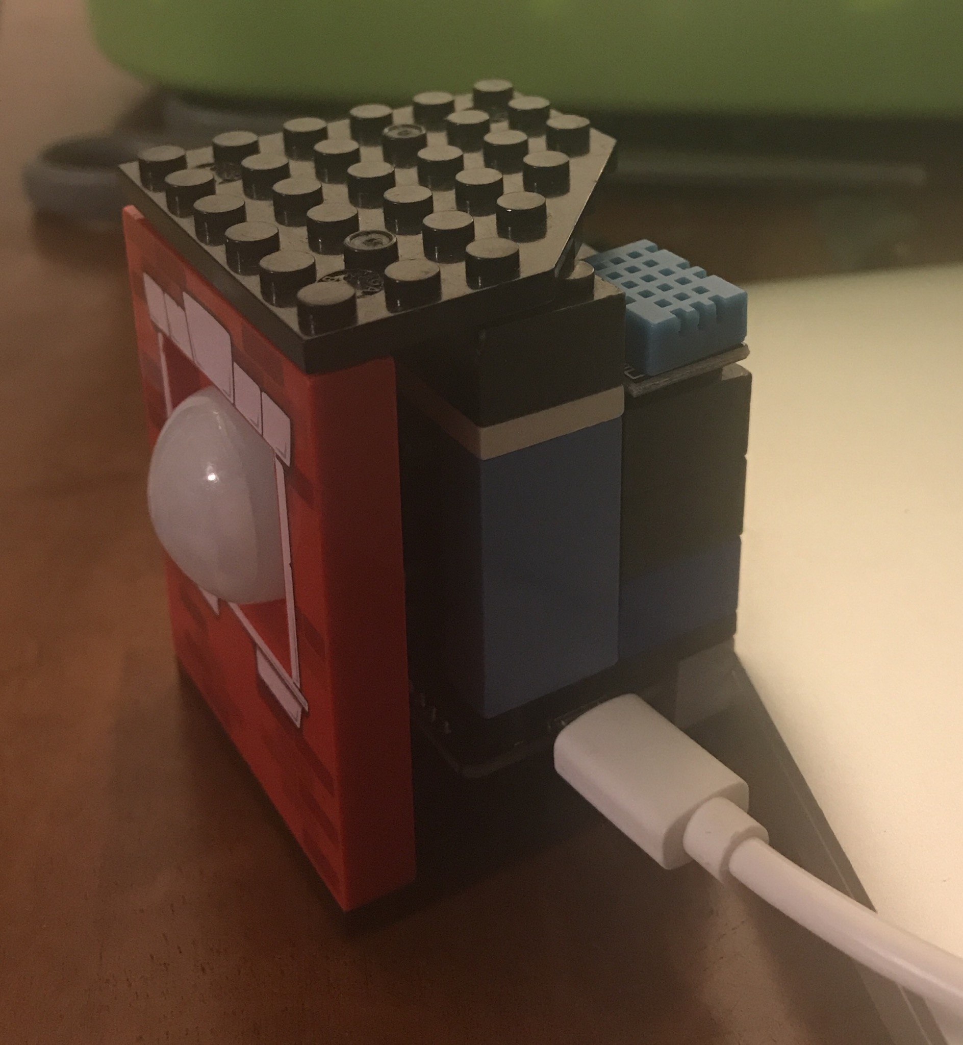

The lego version is inspiring, too. Actually, I still have some LEGO stuff around. Will see what that’ll make!

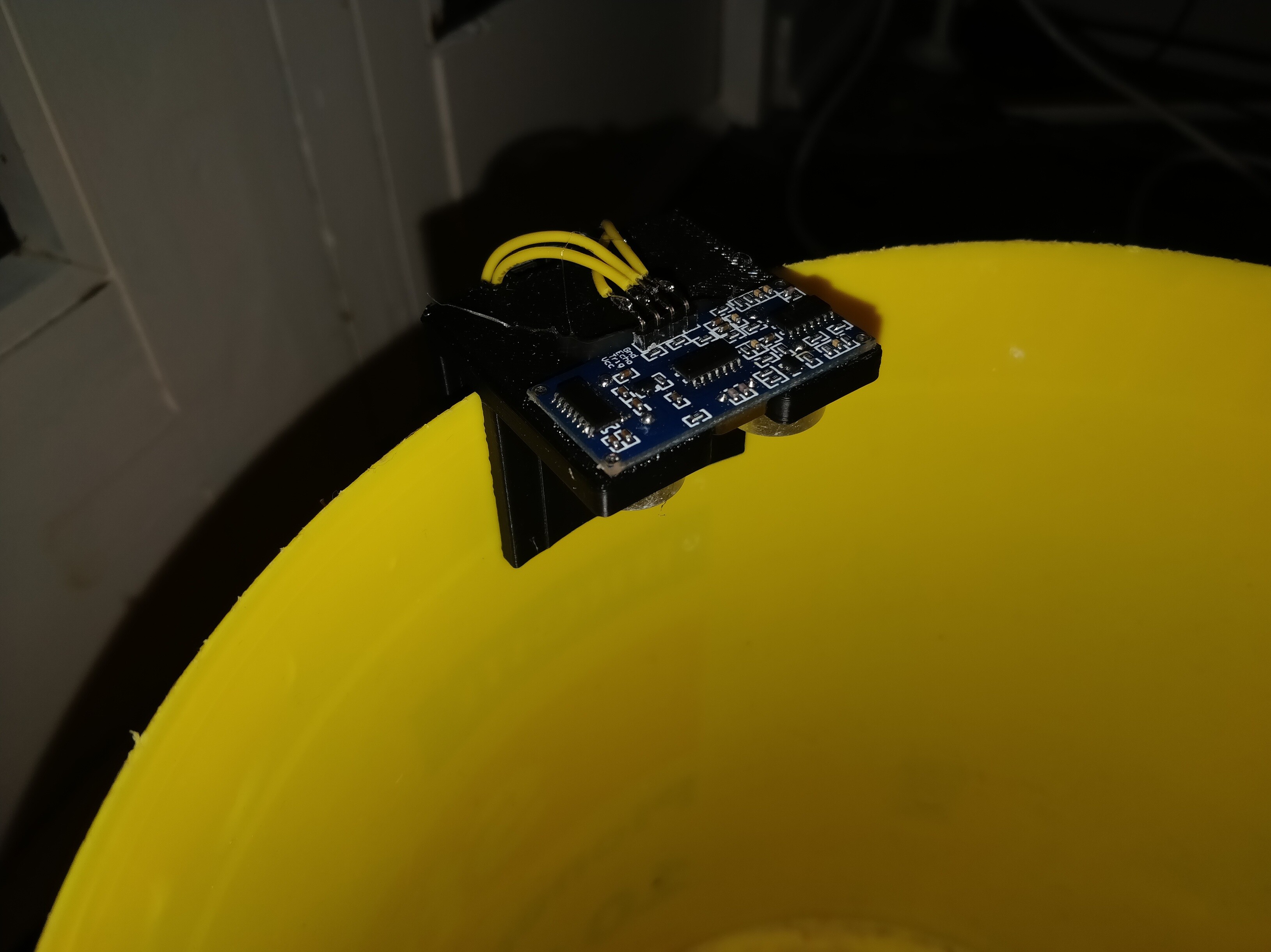

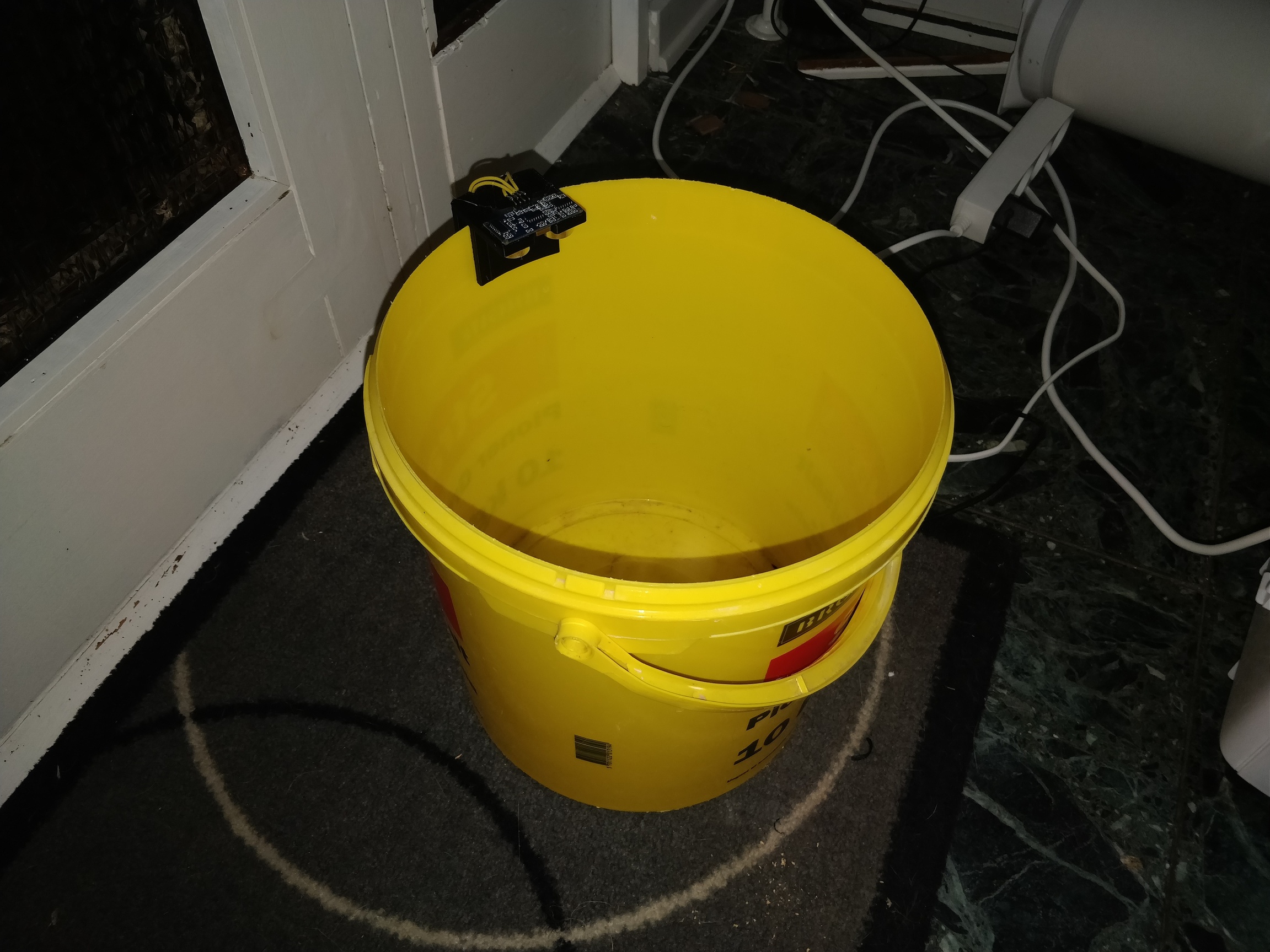

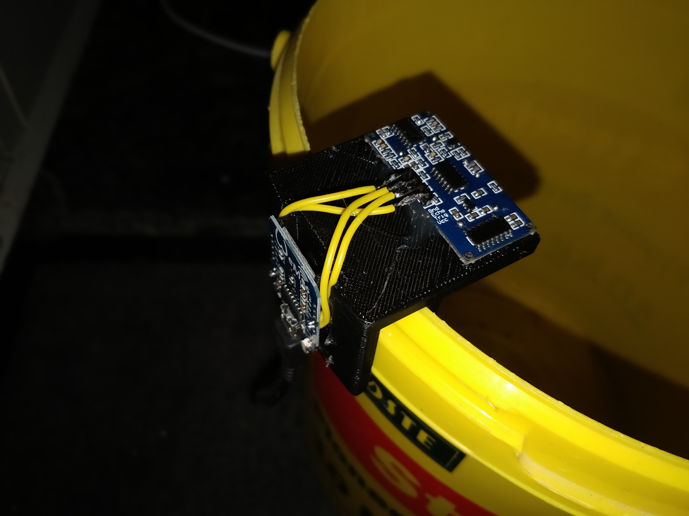

A few days ago I made a small device for monitoring water level in a bucket. The bucket is used by my aircondition for condensation water, and I am now working on automating the aircondition unit. With the water level sensor, I am able to stop the aircondition before water overflows.
The device is pretty simple, it is only a Wemos D1 mini and an HC-SR04 based ultrasonic distance sensor, which is mouned on a 3D printed bracket with hot glue. The device can then easy be removed from the bucket when it needs to be emptied.
Data is send back to openhab over MQTT.
