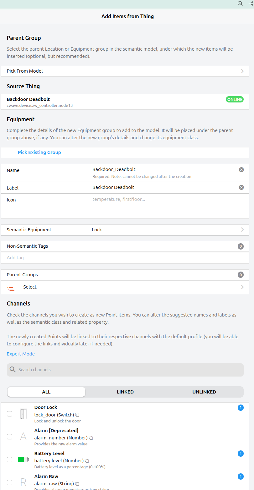

Just to elaborate a bit on @hmerk’s reply, since OH 3 and bringing the semantic model as more of a main feature of OH this has been supported, and the latter statement is enabled through this ability.
There are several ways to do this. If you’ve already an OH system set up and configured and are just adding new devices the most common approach is:
  1. From the Inbox discover your new Thing(s) or manually add the new Thing(s).
  2. From the new Thing’s page, under the Channels tab there is the option to “Add Equipment to Thing”.
  3. Clicking that will open a form where you can choose the location where that Equipment will be placed in the semantic model, name the Equipment, and choose the Channels you want to create the Items for.
  4. Fill out all the details and click save and the Equipment Group Item and all the Items linked to the Channels will be created in one go.
  5. Also, once created, the Equipment and all its Items will appear in the Locations, Equipment and Properties tab of the Overview Page in MainUI automatically.
As mentioned, you can also get to “Add Equipment to model” from the Model Settings page in MainUI. You can also “add Points to model” which is what you would use if the Equipment already exists and you want to add more Items to that Equipment.
