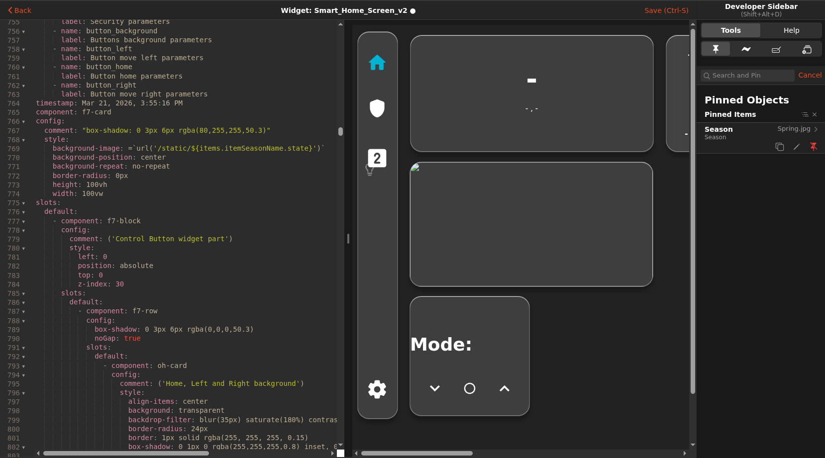

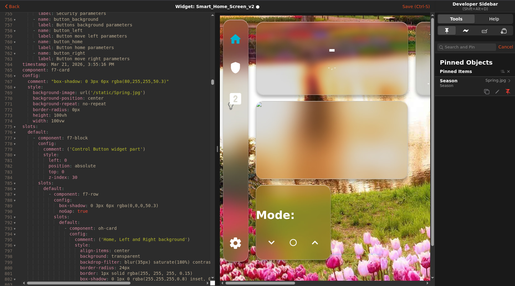

I would like to request some help. Im trying to make the UI background change with the actual season (script is done, change the item), but Im not able to load in any way the background image. If Im using the background-image: url(‘/static/Spring.jpg’) its loading the image from the static folder but if I try to use my item which is itemSeasonName its not works.

If the actual name is your item is itemSeasonName, then you don’t need to use the widget property at all. You can access the state of items directly in the widget expression. In this case, I would use a string template to build the full string value:
background-image: =`url('/static/${items.itemSeasonName.state}')`
I I tried this but its not works:
If I use this its loading the image:
okay, found a way :smiley:
component: f7-card
  comment: "Main card element"
  style:
    height: 100vh
    width: 100vw
  default:
    - component: oh-image-card
        comment: ('Dynamic background image')
        url: =@props.itemSeasonName
        style:
          z-index: 0
          height: 100vh
          width: 100vw
          left: -8px
          top: -2px
          position: relative
          object-fit: cover
    - component: f7-block
        comment: ('Control Button widget part')
        style:
          left: 0
          position: absolute
          top: 0
          z-index: 30
The item value looks like this: http://:8080/static/image + format and in this way its good and it can be dynamically changed
