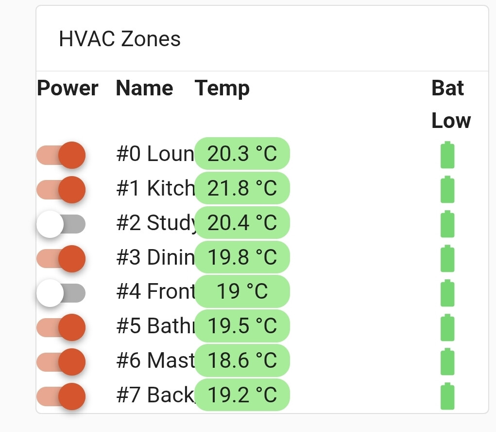

great that mostly works however it looks like the column space hasn’t been removed
you can see in the below screenshot my “Set Temp” column is hidden but not removed as the name is truncated

Move the visible property to the col component and it will remove the entire column.
just for future reference
- component: f7-col
    visible: =device.desktop
    default:
      - component: Label
          text: =items[props.zone_set_temp_item].state
          style:
            width: 80px
