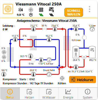

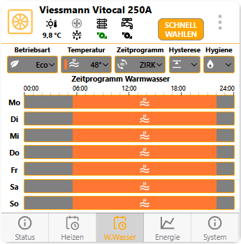

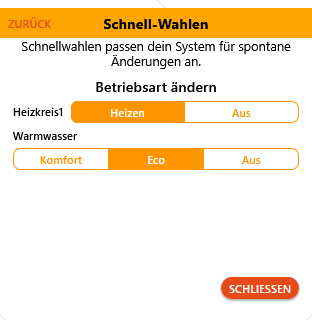

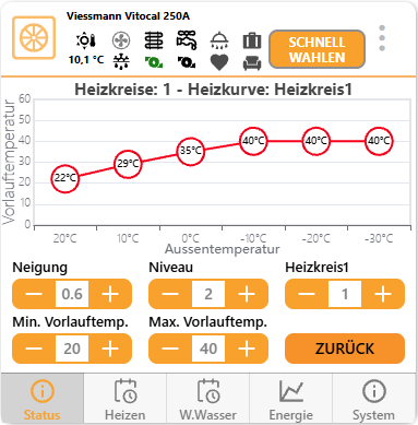

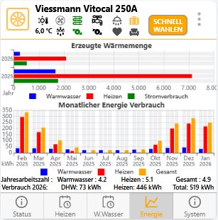

A Widget trying the bring the complete functionality of the ViCareApp from Viessmann into openhab.
Screenshots

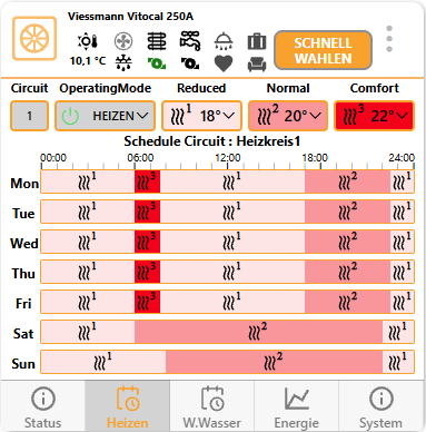

  • Changed those widget-parts dealing with heating circuits to be able to handle upto the 4 possible heating circuits.
    So now it is possible to set the heatingcurve temperatures and the schedule for all circuits.

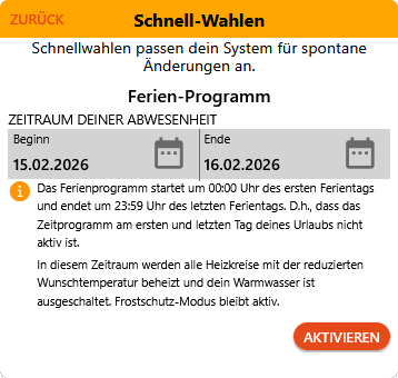

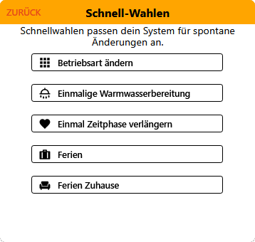

  • For Holiday and Day(s) At Home program there are 2 widget possibilities:
    wp_fastChoice, wp_fastChoice_setter and
    wp_fastChoice_Proxy, wp_fastChoice_setter_Proxy
    The latter use proxy-items for setting start and end dates avoiding latency when entering the date.
