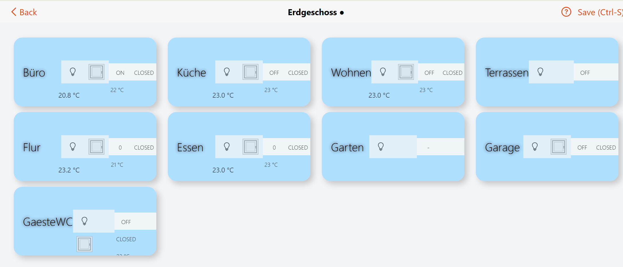

Dear all after migrating to OH5.1 the visualization of myroomcard is unfortunately somewhat broken. Before the migration to 5.1 every was rendered correctly and the pictograms and status were on separate lines and transparent.
I am not a YAML Expert. Below the codefence. It is based on the original roomCard from Andras Uhrin (never published to Market place, but I like it)
Anybody any idea what to change on the code to get the transparency back and the line breaks as they were before .

Hi JustinG,
the hint with the “display-block" in the oh-button did solve the problem. Many thanks. There was no additional need to change the transparency.

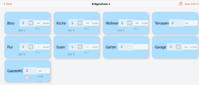

this is how it looks now

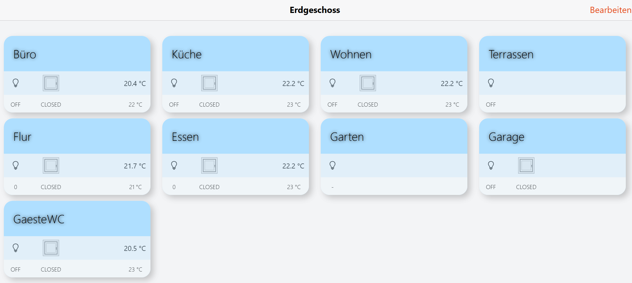

How should it look?
yes, this is what I liked from the original widget from Andras. All rows with different transparency and in config you can pick the color.
First Row Name of room
Second Row (dynamic) Icons
3rd Row Status of objects used
I think the individual objects are managed within columns but I am not 100% sure as this is where my code know-how ends :frowning: .
